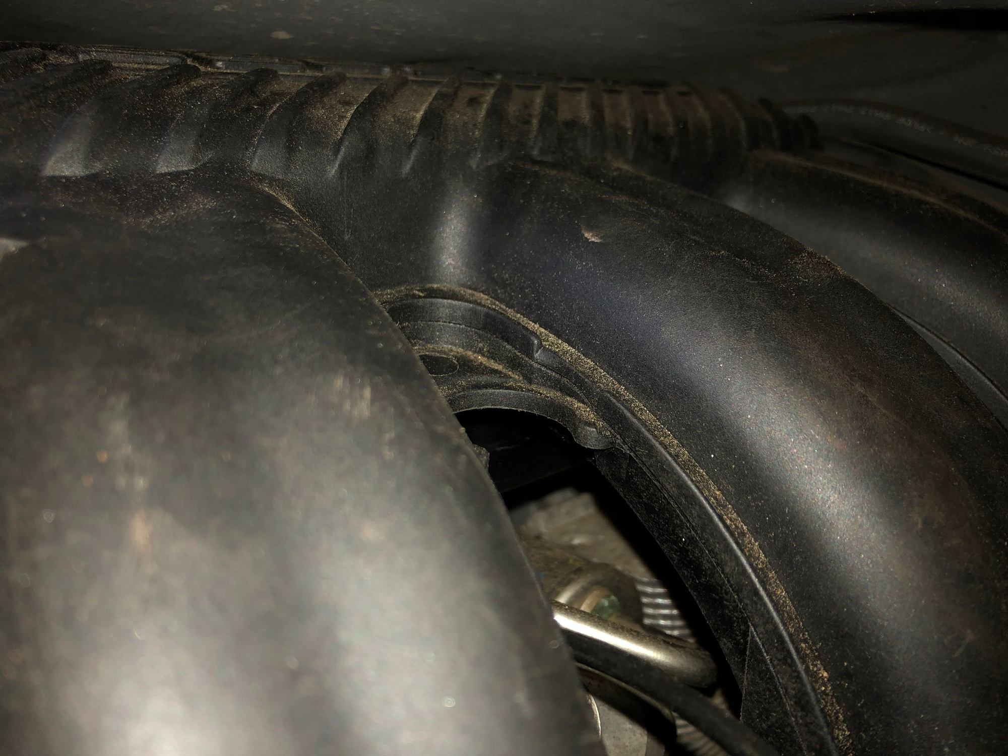

Does it slip into this recess?
Old Sep 10, 2023 | 07:59 PM
pdxmotorhead's Avatar
pdxmotorhead
Joined: May 2019
Posts: 1,739
Likes: 425
From: USA/Oregon
Yes with the probe pointed up IIRC..

Old Sep 10, 2023 | 08:07 PM
168Sierra's Avatar
168Sierra
Joined: Oct 2022
Posts: 363
Likes: 440
From: Signal Mtn TN
According to the PET the probe points down, wire connector is on top. Insert thr probe into the rubber grommet, lube the grommet wit5h a little soapy water and push it into the slot. It is difficult to push in, the lube helps a lot.
+1 on getting the coil shields.
Mark
Old Sep 10, 2023 | 08:11 PM
pdxmotorhead
Joined: May 2019
Posts: 1,739
Likes: 425
From: USA/Oregon
thanks for the direction note, when I got my car it was also laying loose, I could not get it to go in pointed down due to the wire length but after the engine replacement is pointed down.. I think it got mis routed at some point before I got it..
Old Sep 10, 2023 | 08:27 PM
jdsculler's Avatar
jdsculler
Joined: Oct 2018
Posts: 152
Likes: 45
From: Massachusetts
Thanks guys! I found a picture of an engine out of a car showing its location. Thanks for the soapy water tip!
