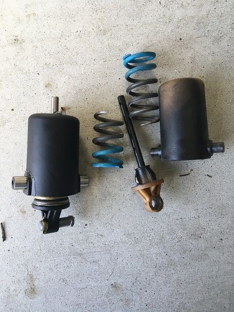

And it looks like you've got your first thing to fix, if the clutch pedal force is too much. There is a 'helper' spring that breaks. They all do it. Here's mine. Replacing it is fiddly, but easy. It makes the pedal pretty light. Seems too light for type of car. Some replace it with the version for the turbo which uses a different spring.

I was going to bring this up. I just got my clutch replaced and its still quite heavy and bites about half way. I have to check my assist spring (Could have been removed for all I know). Is there any way to tell if its broken without removing? Its not that expensive so I would likely just order one before removing the old one if there is no way to check before removal.
EDIT: I just got in there and looked up and the spring is there, and pressing the clutch in, it appears to still be in one piece from what I can see. When clutch is pressed, can see the spring itself, but man was it difficult to physically push the clutch in with my hand while in that position. I guess I should just order the spring and replace it and see if its any better.
