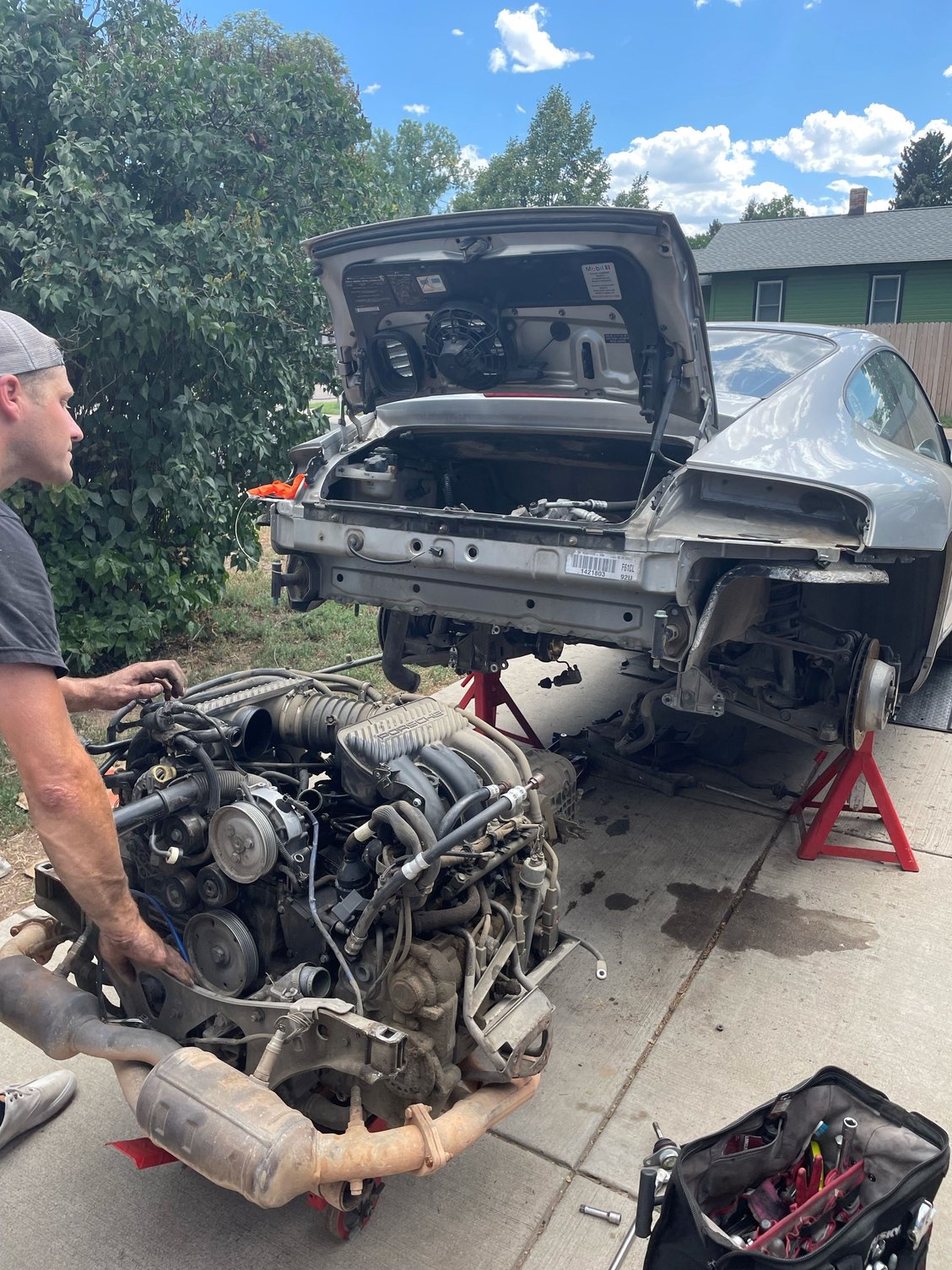

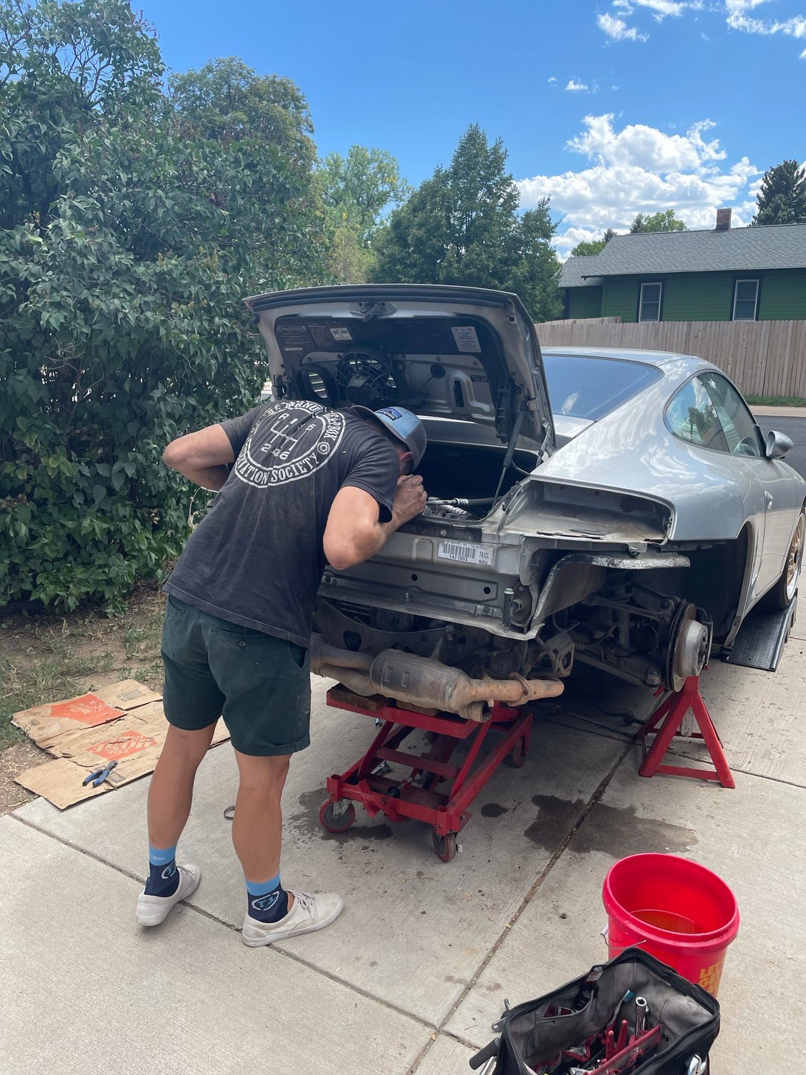

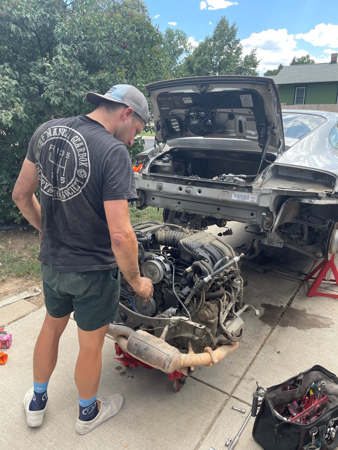

Not other than IMS and the clutch/slave. Considered port and polish as well as exhaust, but really, these motors are so temperamental that I am choosing to do the necessary items. I inspected the IMS, it is the original part number, though, it is in great shape with no weeping. Regardless, I do not want to be a part of the 5-8% of failures. Period. haha. The motor is actually already in, running, and I will drive it about 3-5k before pulling gearbox to do both the aforementioned. I wanted to make sure it runs as expected as I do not have an engine stand to run it on.
Thanks a ton on the support mate, much appreciated. It really is a simple swap. Simple.

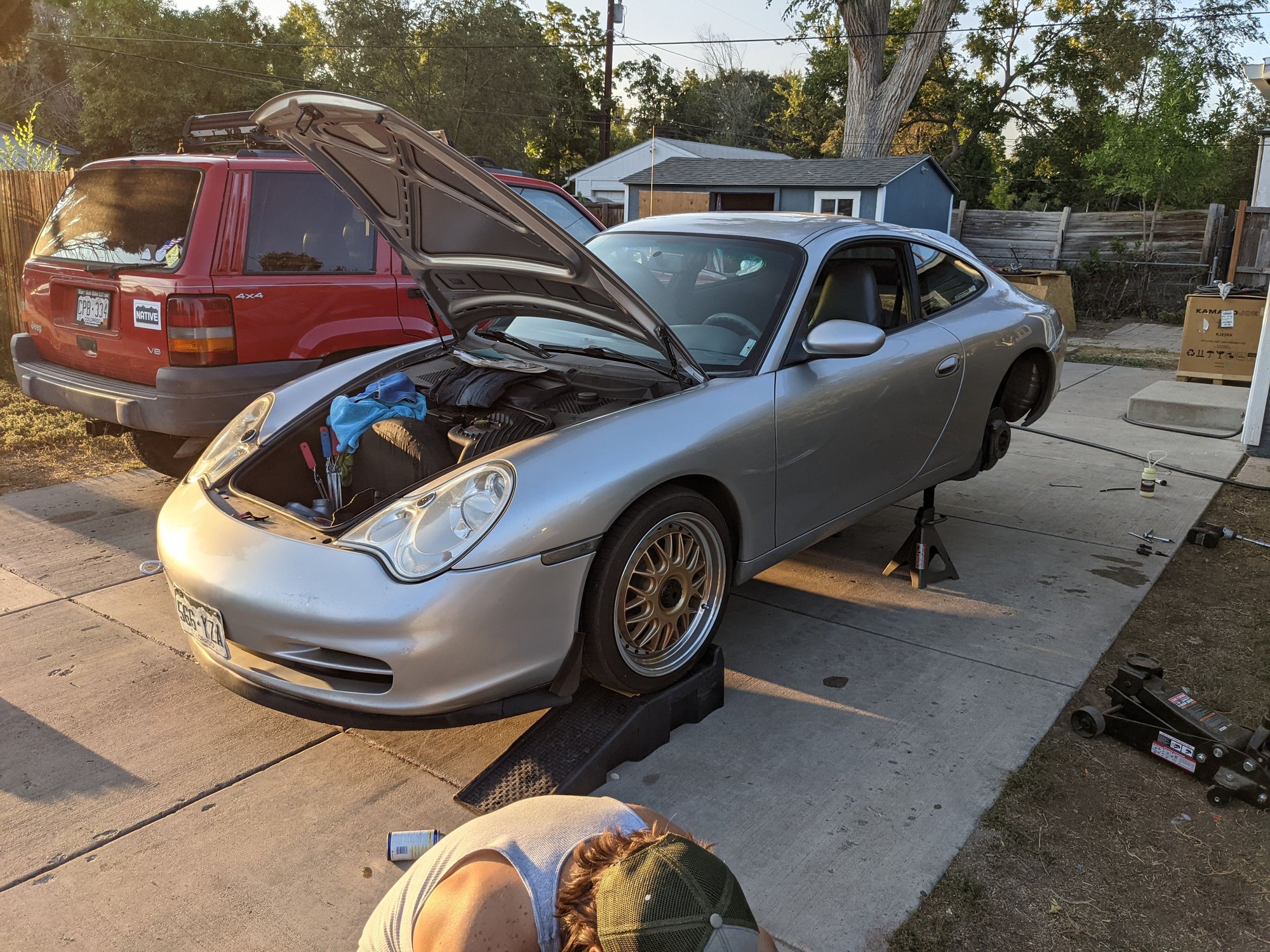

Welp, new clutch in today and stabbed the gearbox. She runs and moves. Couple minor things to finish up.

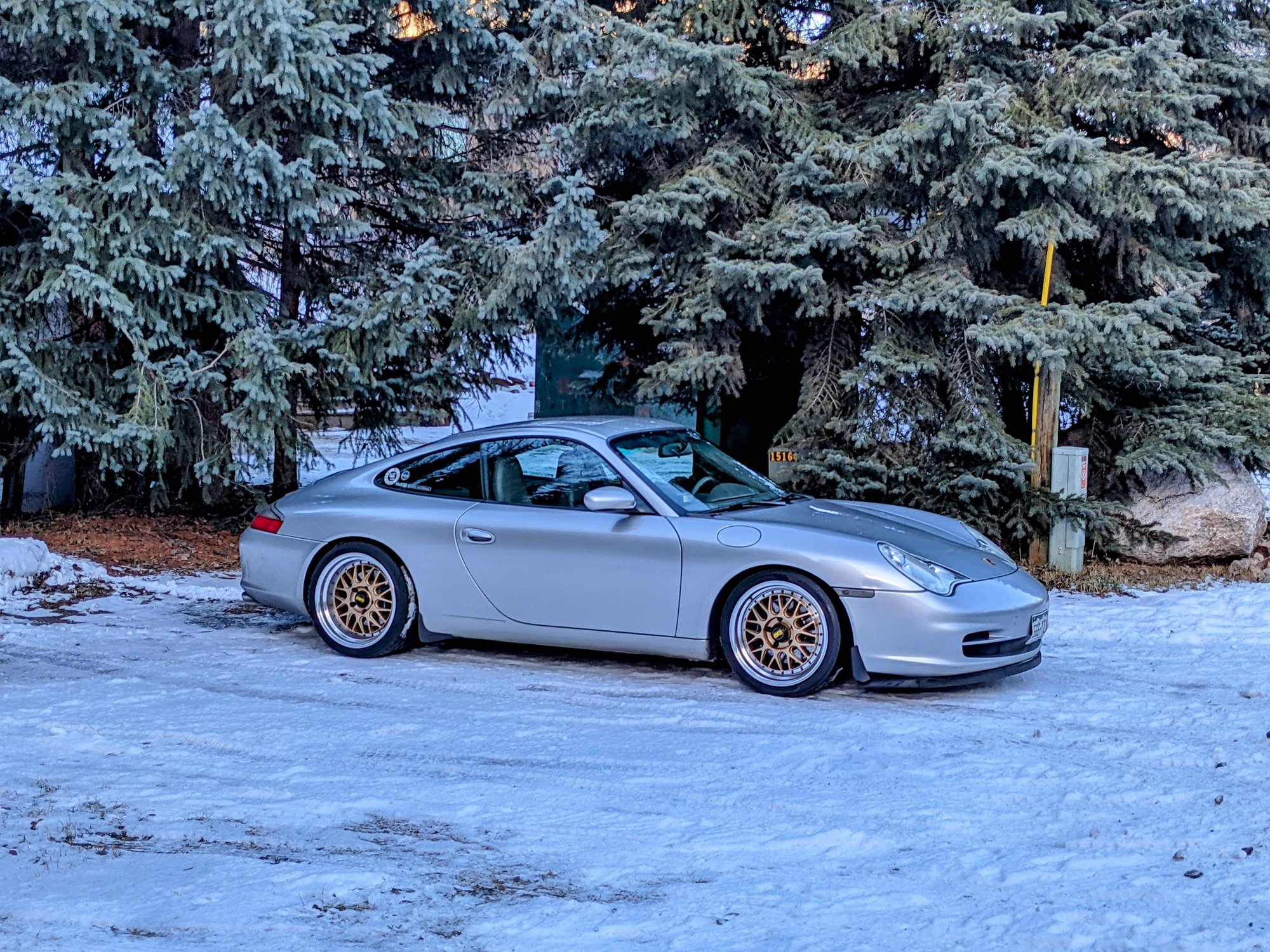

Had a couple DM's about the car. So I decided to post up on current status. Car is running well, have driven it about 5k miles. The 40k motor I put in has been running well as well as the new clutch. I have been using 5w-50 synthetic on this motor, I still feel the 0-40 is too thin. Overall, motor swap was relatively simple, straight forward, and not as time consuming as some might expect. Some updated shots below. I plan to pull the motor again this spring to do the IMS bearing as I was struggling to get parts in time previous round.

Thanks for the update. Gotta love engine swaps in the driveway with some jack stands and some hand tools The stance on those wheels looks absolutely perfect! Well done.

Thanks man. I did tons and tons of measuring and research to make sure they were perfect. And yes, jack stands and motor swaps are far from my favorite idea. But, these are for 3500 HD trucks haha.

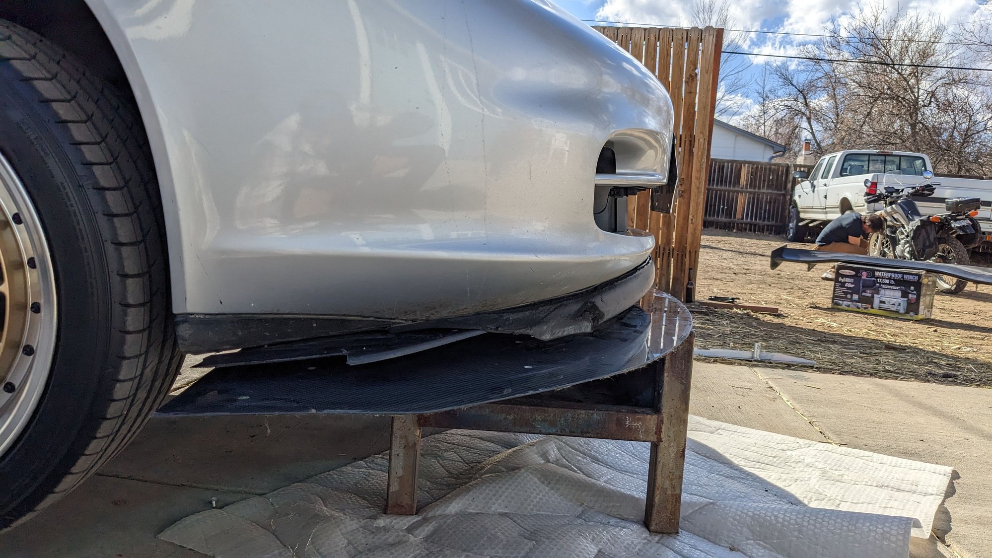

Quick update to the rebuild..... Well, motor in for 20 months now. No issues thus far with about 15000 added to the clock nearly. Just did new set of tyres and some aero bits started. The front splitter is all fabricated mounts, by me of course, an APR carbon splitter and an APR GT rear wing. The wing is still in fabrication state as I am modding a secondary deck lid to accommodate the APR uprights while also building chassis-mount uprights. Splitter gets glitter water paint for downforce info and correct air flow. That is all being advised upon by a nasa fabricator, but it has come out well thus far. I have yet to see a 996 with "proper" aero. It is rare. Normally you see the typical GT3 bumper or aero front spoiler, that is about it. So this project has had zero influence by any build yet.
Regardless, some build shots, mock up shots, and current status. I may trim the outer edges for the splitter. In addition, widebody RSR kit is on the docket for later in year. Obviously more than just a bolt on and run kit requiring new wheels, tyres, and of course bodywork.

If you really want the splitter to put in work, get some tunnels in it. I like the way you mounted it though.

As for the splitter yes, it worked out great. The piece has a place to go and compress but is solidified with 6 points including the original bumper mounts. They have an additional tack or two as a result as well. I am using adjustable splitter rods in the next week or so as well.
