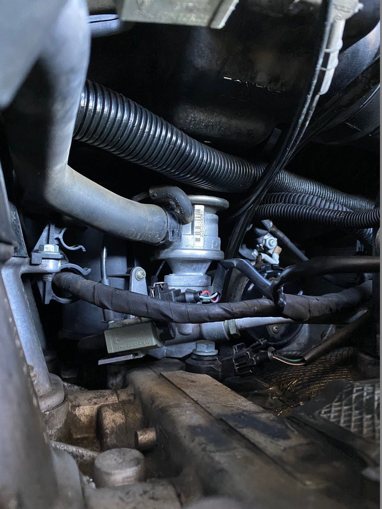

Change-over valve is the rectangular pneumatic-electric actuator in the picture. There's a second one that's easier to get to. Cheap and easy to replace, so why not?
Vacuum tank looks like a serious job to replace. I will put that off unless nothing else works.
Hoses I will order and replace anything that I remove
What is the "vacuum valve?" The big silver thing in the middle of the picture? That looks (and feels) like a major job to swap out.
I think I'll order the change-over valves and hose/pipe parts and replace what's easy to get to. Then I'll put everything back in and see what happens.
Not sure if it's worth it to put the battery in and try to actuate valves with the Durametric. Might be a good next step after putting everything back in and doing a road test.
