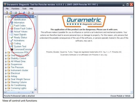

Don't take it back to smog until you know that the readiness monitors are set. No codes and no CEL does not mean monitors are set. I was under the impression that most scanner would tell you about the status. I have a cheapo OBD scanner for my non Porsche vehicles that shows the monitor status. Of course, Durametric shows it. I have a VAG-COM for my VW's that has a procedure to actually run the tests to set the monitors, it's really nice to have. I would expect there is a Porsche equivalent, PIWIS?
I have a Durametric reader. How can I check monitor status with Durametric?

here's a picture from the online manual. Just click the left menu item 'ready status'. It will show the status of the monitors. Apologies that I don't have the next photo. I don't have my car right now. Good luck.
