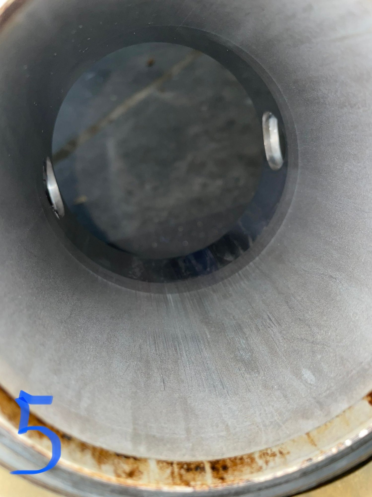

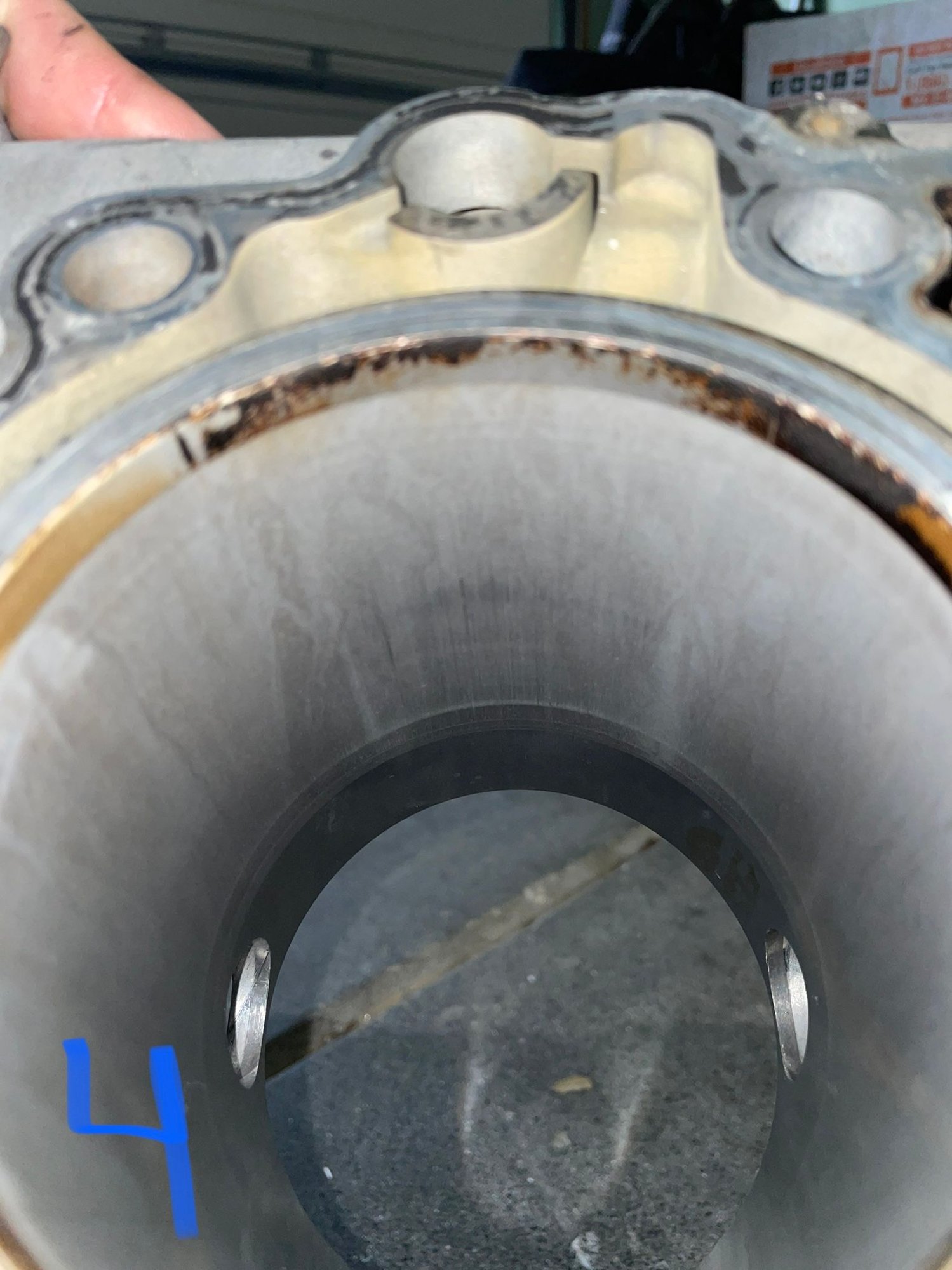

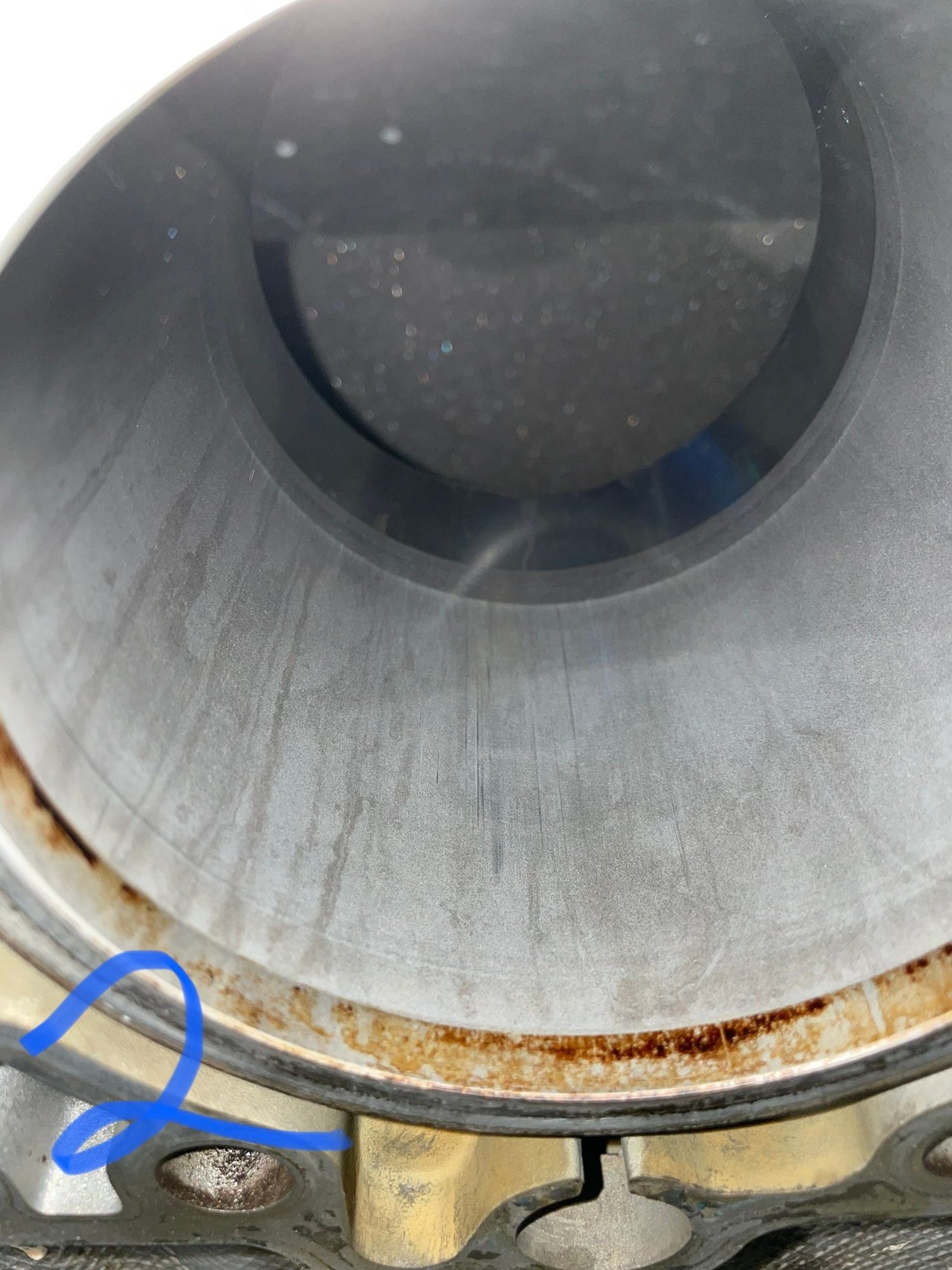

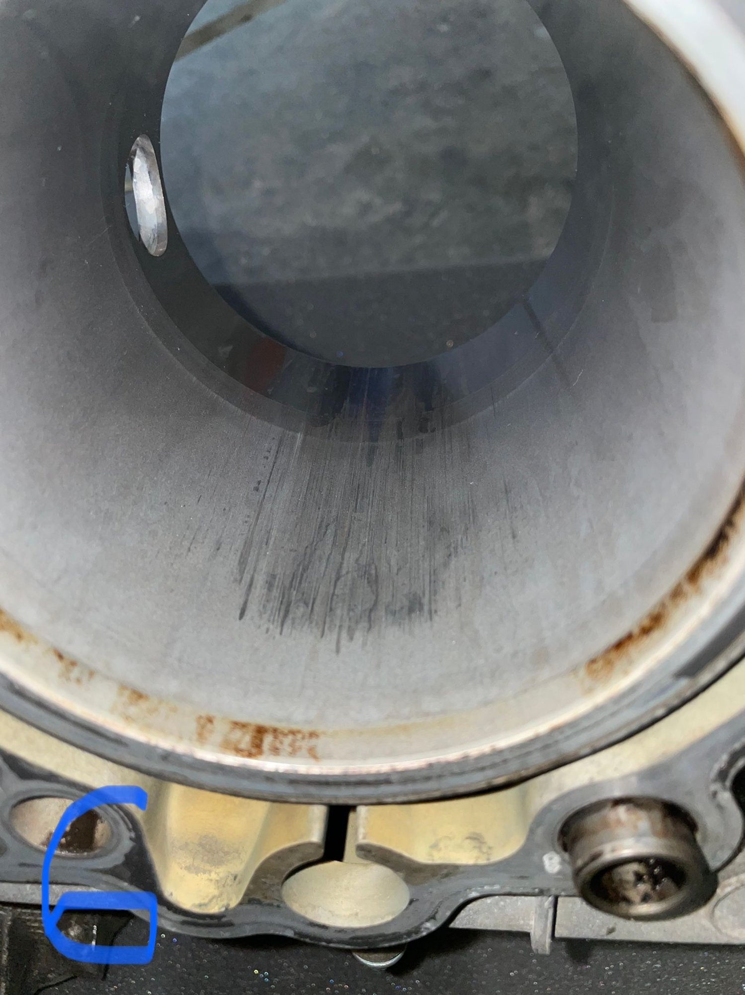

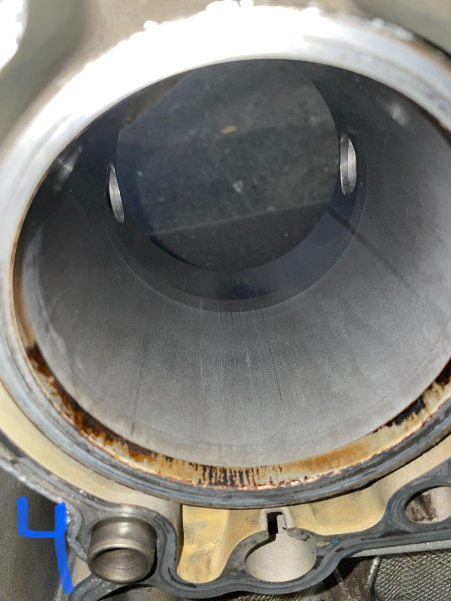

Hey guys! Not sure how many of you work on your own cars here and or have experience working on them, but need help from someone who knows what they’re talking about. I got a 1999 Porsche 911 that I had a main bearing due on me and luckily didn’t do too much damage so most of the engine is rebuildable, which I’m doing myself. But, before I got on, was wondering if some could tell me if my block for Cylinders 4-6 is still any good? Got a little bit of scoring but not much and it’s all still smooth and round. Was wondering if an expert (hopefully in this group) can help me out a little. Will I need to replace the block or am I good to just throw on a new set of rings? Btw also replacing pistons with either JE or Wossner. Thanks again in advance
ps. Also images are market with the cylinder number to help identify to culprit. Thanks again

I'm not an "expert" but my opinion is if you were to rebuild the engine using the block as-is, you will have wasted your time and money, and be disappointed in the long term.
I think your best direction would be to have the cylinders sleeved with new Nikasil sleeves, however you certainly could proceed as you see fit.
Jake Raby with FSI (Flat Six Innovations) has been very generous with his experience and knowledge; you might want to view some videos on YouTube that he has provided related to bore scoring.
LN engineering provides the Nikasil sleeves.

Yep, several bores are scored, and will require attention. #6 is at Stage 3 scoring, and will progress quickly from this point.
Be very careful deciding which way to go with this, component compatibility is essential. Factory Lokasil cylinders do not play well with high silicon content forgings like JE, and others.
I see people cut corners on this all the time. It doesn't end well, but it works okay if doing something twice doesn't bother you, and you have to learn things yourself.

Sorry but if you are looking at that last bore and are thinking you may be able to just throw in some new pistons, are you really sure you want to tackle this build?

Like all others have said, your cylinders are done/junk. Since you had to ask for opinions on this I will assume this is your first Rodeo, tread carefully my friend. There have been many an able bodied person fail to get an M96 up to snuff.
You have two major components failures to deal with first. the crankshaft ( you said you spun a bearing) and the cylinders/cases.Both are manufactured using special processes not common to most engines, and require special repair/restore processes that are also not common. Then there is all the little things that will need to be addressed that can trip up a good intent..
