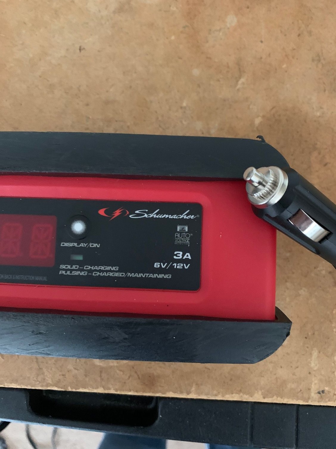

Get this...comes with the cigarette lighter plug. Got it at AutoZone

There is a difference between a trickle charger and a maintainer (like Joe just posted). If you want to be able to leave it on long term without worry, get a maintainer of some variety, lots out there. If it’s a roller and battery is disconnected, it should hold as there is no parasitic drain anyway, so lowpue’s advise is also viable.

A trickle charger applies a constant low current all the time. A maintainer, has a small brain, that lets it monitor battery voltage, and alternate current applied to maintain peak condition of the battery. Basically, you can leave a maintainer on 24/7 for months, but a trickle can damage the battery if left long term.

I like the Deltran maintainers. I use a 1.25 amp for winter storage on my 996.
I believe the difference between a trickle charger and a maintainer is the trickle charger constantly provides a low amperage charge...trickle as in water faucet barely turned on. Not necessarily the best for the battery. A maintainer has internal solid state equipment that monitors the battery charge condition and applies a charge only when needed. Some even vary the demand/supply to the battery to keep it more healthy.
Cigarette adapter only works on a vehicle where the cigarette lighter is hot all the time i.e. even when the ignition switch is off like on our 996's
