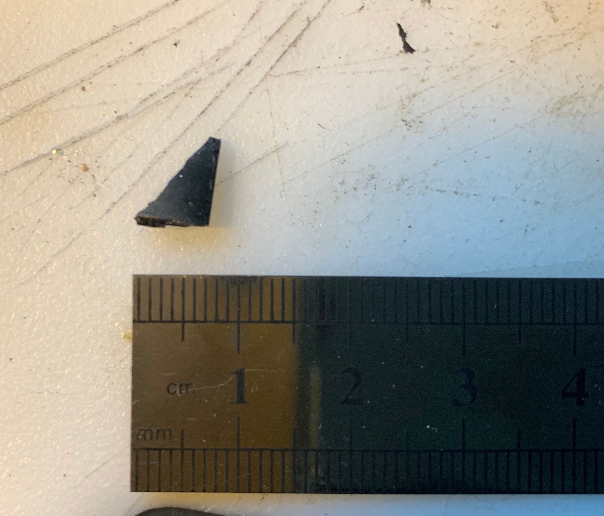

On opening the case up a tiny piece of black plastic fell out....when I say tiny I mean tiny triangular 2mm x 1mm but couldn’t see anything from where it could have broken off. The main side pieces on the indicator stalk as featured in the video were fine and the big strong spring sat evenly in the correct position.

Ah. I think that tiny black plastic piece is your answer.
Where it goes will likely fix the problem. However, if it broke off, I highly doubt it can be reattached.
A replacement turn signal stalk might be your only solution.

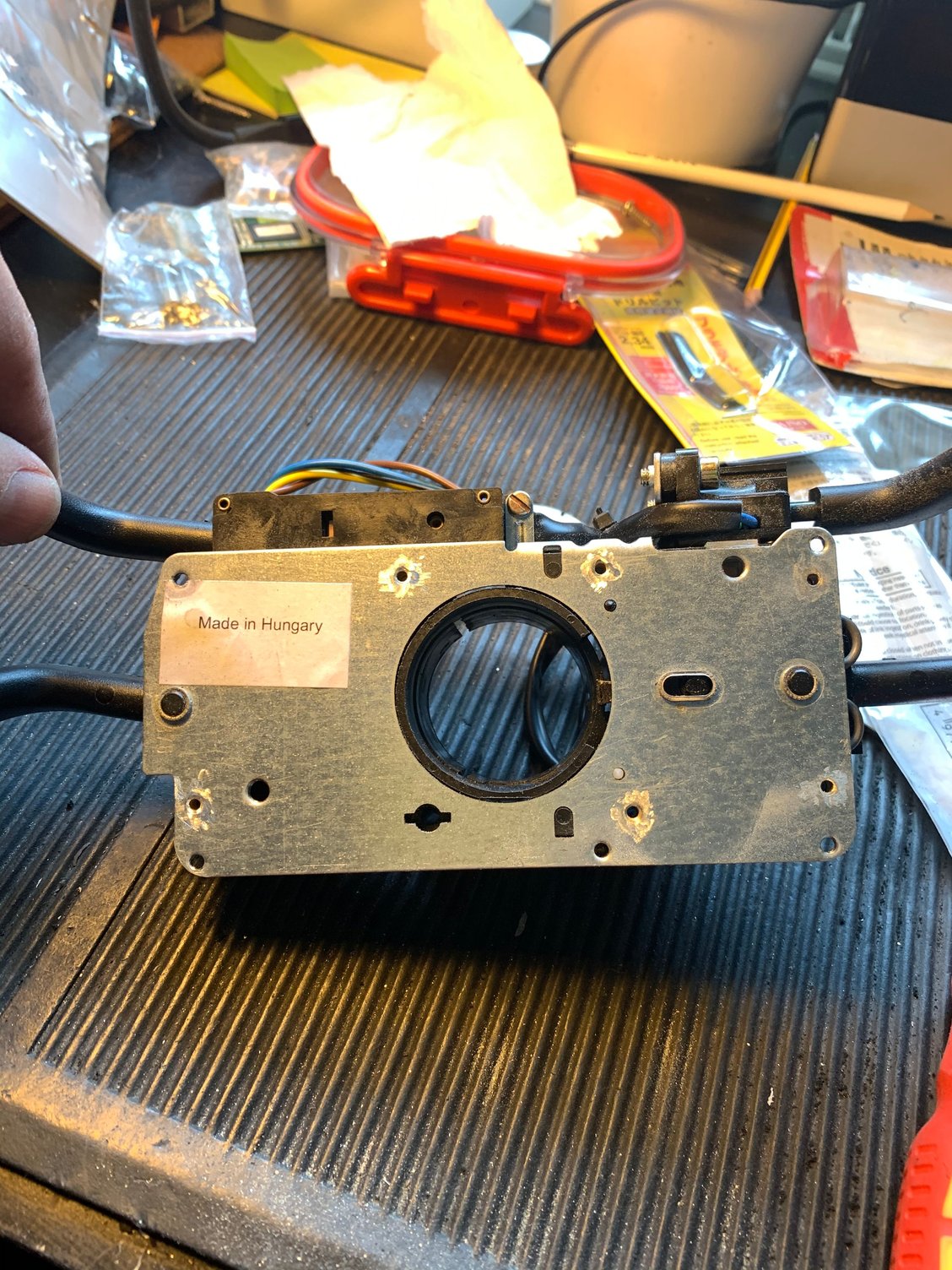

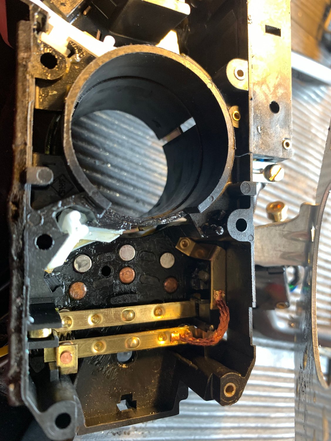

Inside Indicator unit
Another view

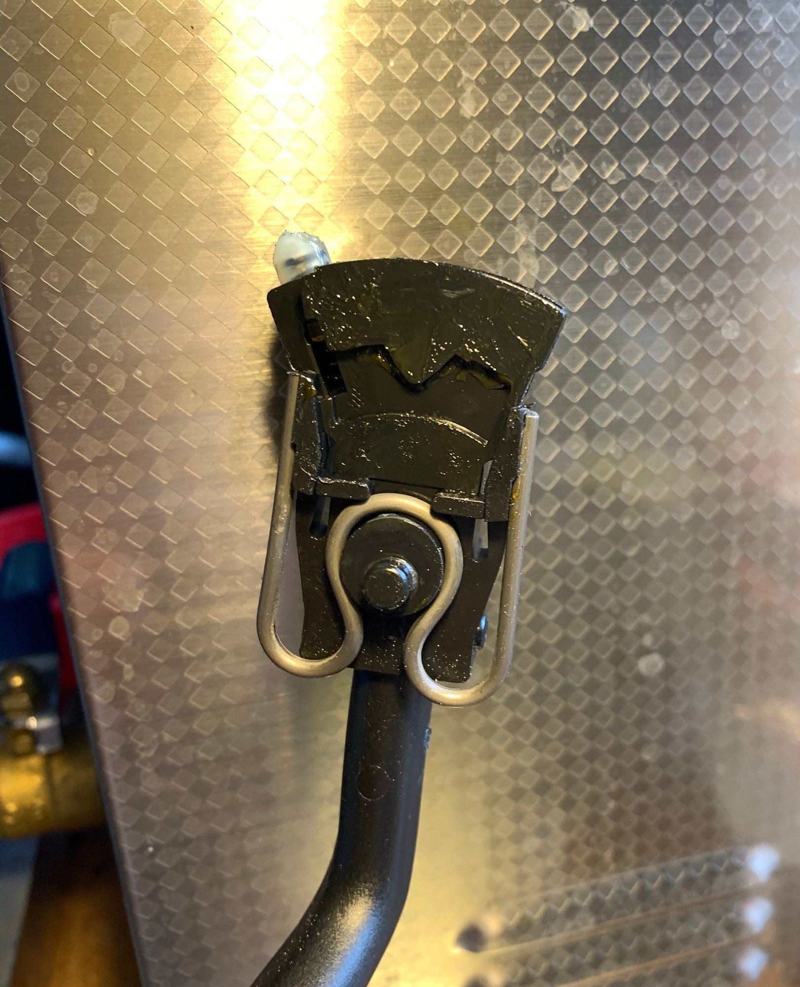

I've done mine, so I know what it looks like. Can you show a picture of the stalk? I can't see it clearly. I think I am seeing the part of the stalk that goes into the module, and looks like both tabs are broken off. Those tabs are what is needed to hold the wire spring in place and allow teh stlk to snap back into off position. If they are broken off, the stalk is toast. You cant glue them back on. This type of plastic glue doesn't work so well. Crazy glue won't work.

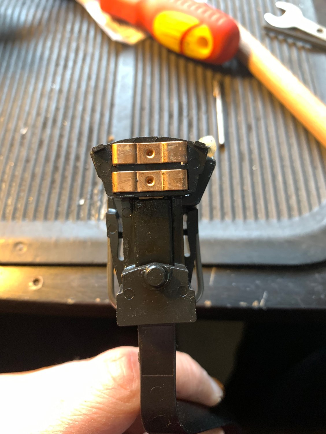

Thanks Jim here’s a couple of photos of the indicator stalk itself.
One side of indicator stalk
The other side with spring and side wings intact

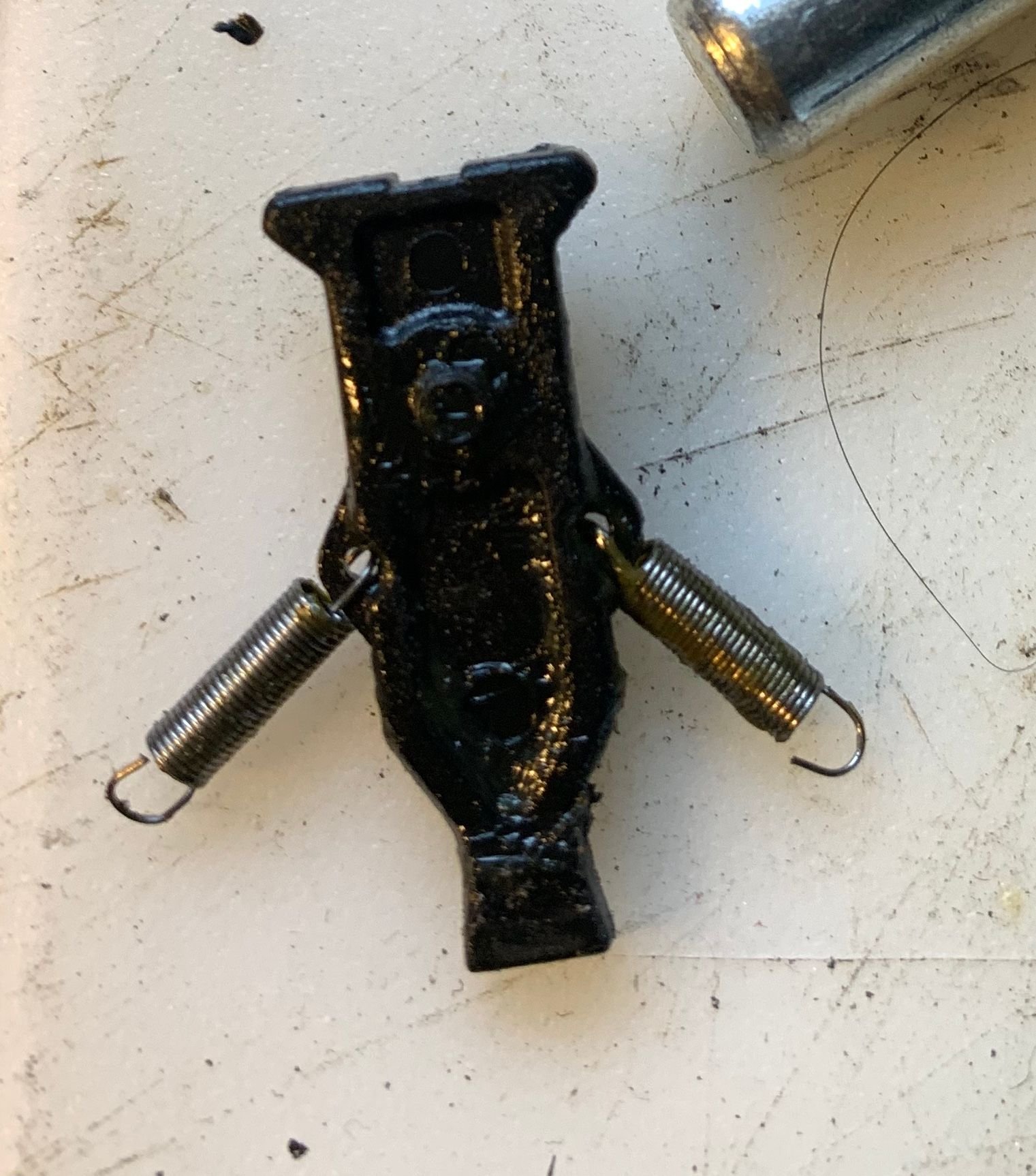

Here’s the slider part that located into the case slot and moves when you push stalk either way
The whole unit
Slider thing

Well the tabs are there, so its not that. The tabs are the part that always break and thatis what prevents the indicator from returning to off.
Hmm ... so if the mechanical parts are good (when you put it back together, the stalk could be set in the up down and middle position), not a mechanical problem.
If this little piece that fell out is so tiny, I doubt I can tell where it came from, but put a picture up anyway?
If its not mechanical, then has to be electrical.

Here’s the bit that fell out of the unit when I dismantled it sorry don’t have any Imperial rulers
Tiny broken bit

Yeah, have no idea where that part is from. I'm at a loss. All I can say is what you have done already. Reassemble and try moving the stalk and try moving it and see if maybe it becomes evident where that broken piece is from. I know that is hard, since it is a pain to keep all those springs in place and not have them all pop out.
If it were to be electrical, then I assume that to cancel there needs to be current through one of the brass strips (or lack of current?) that causes the spring in the the clear piece on the stalk to retract and allow the stalk to return?
Sorry I can't be more help.
