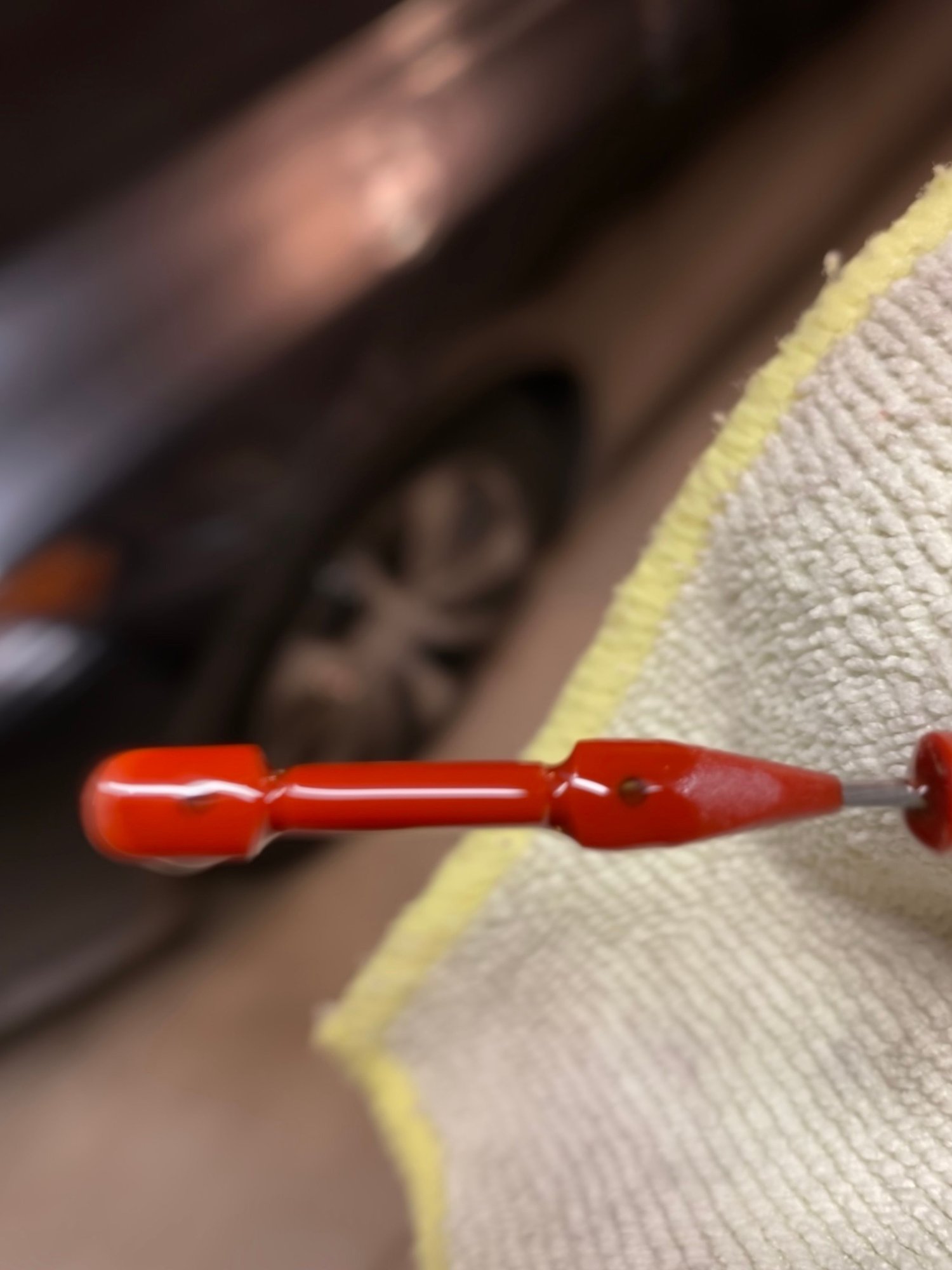

I had my oil changed recently in my 99 996 at a reputable Indy shop. Billed for a total of 9 quarts. Digital gauge will fluctuate from one tick above full level to at full level. This is what the dipstick reads both cold and warm. I talked to an associate at an actual Porsche dealer who didn’t seem too concerned. He recommended taking it out for a couple “hot laps.” Just thought I would get some opinions on here. No abnormal symptoms otherwise after driving for 50 miles or so. Thanks!

Looks like a tad too much to me...
Also, why would it read the same when hot vs. cold? Seems strange.

I certainly wouldn't trust an associate at a Porsche dealer. I have seen comments that any overfill is BAD. Suggestions are usually drop the filter empty and get the level below full. When you say cold do you mean overnight cold?

1 mark low is better than 1 mark over,, My AOS / Followup ENigne fail is related.. You need to just start reading ,, this has been discussed endlessly..

Make sure the car is level when checking. If it's still reading that high I would remove the oil filter to drain some of it off. Halfway between low and full is a good place.

9 qt. is little too much, hence the slightly high readings.

I would concur with others, just drop the filter to lower level a bit. The resident pros recommend the level to be midpoint between high and low on the stick and digital gauge. FYI being "billed" for 9 litres only means they used more than 8, as you'll be charged even if they only actually use a spoonful.

That's too much - middle of range is best, but certainly NOT over the full dot...

I’ve put 9 quarts into mine before and not had an overfill. The system can take 9 quarts if you drain out more oil than a regular oil change would remove (more time draining or car not flat when draining).
Best not to overfill, there are stories of smoking from burning.
But if you aren’t heaving any problems, and if your car burns a small amount of oil, just leave it.
If you drive short trips, then you could accumulate water, causing an even higher oil level, so if that’s the case, take the oil filter off and drain the filter.
