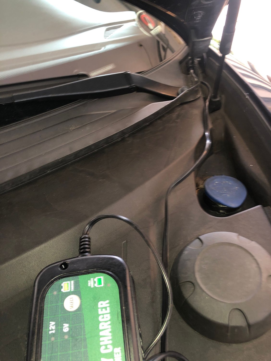

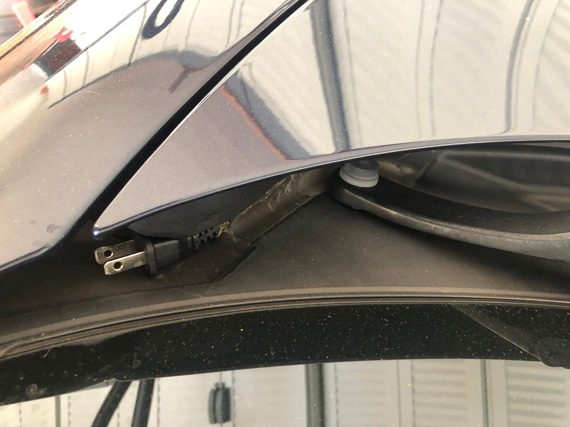

Originally Posted by Freebe
I have a trickle charger in the trunk sitting next to the battery (hidden) tied to the battery terminal with a short extension cord with the end routed next to the wiper and sitting in the area below the window and in front of the back edge of the trunk lid. you don't even see it. it is there all the time.
when I am going to be gone more than a week, I use an extension cord to the plug/wall outlet and drape the orange cord over the side mirror so I don't miss it when getting into the car.
That way you can lock the car.

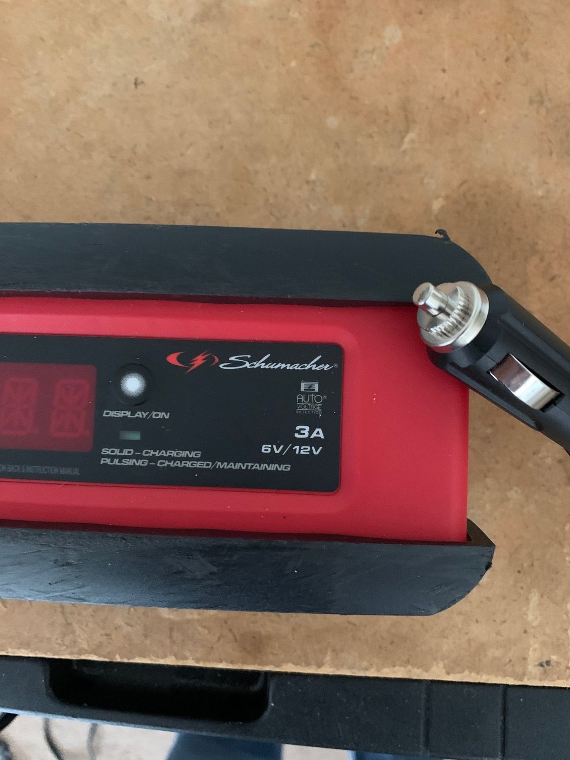

Originally Posted by Mib44
How do you connect battery tender to a cigarette lighter? Is there a mod for this or adapter? Could you also explain, so as i understand the power from wall socket goes through battery maintainer and cigarette lighter and to the battery? Thank you!
Super straight forward. In fact, if you google Porsche’s own battery maintainer, this is how it is setup. Simply take the leads from a Battery Tender, or any battery maintainer, and replace the battery clamps that are usually on the ends of the leads with a cigarette lighter plug. Many chargers have a pre-made plug you can buy, or you can simply cut off the clamps and install a plug off an old 12V auto appliance, like a GPS or such.

Default extension cord up to windshield wiper
Could you please show a picture of this setup?
never see it and always there
setup on my 992. exactly the same on my 996

Ok, I have ordered this cable today, will see how it works.
Funny thing, I was just thinking to replace cigarette lighter with USB ports, but looks like I'll be staying with it))
