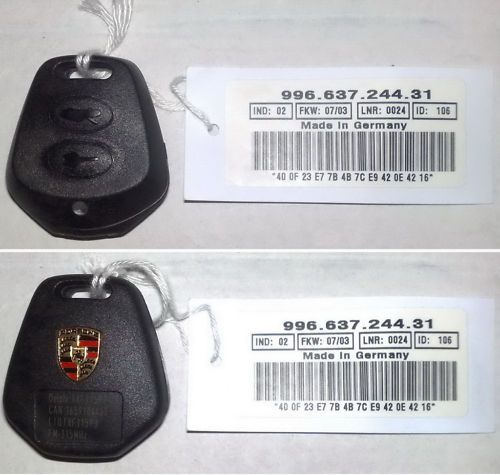

You need this

Hmmm....thanks for the info. My fob from 5150 definitely didn't come with that - is it possible that is only needed with the remote keyless entry functions?

Originally Posted by DBJoe996
You need this

With a laser cut key you will be able to unlock the door, but that is all. You will have to transfer the guts of a working key to that head, circuit board AND RFID transponder pill as well as a key blade.
