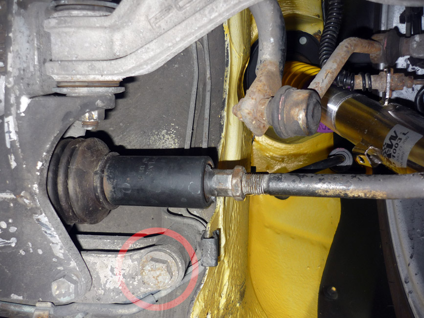

Can someone draw an arrow or describe the front reference point for height measurement in this picture? I have seen the drawing from the "for dummies" thread, but it is ambiguous to me.
(The picture is taken on the right side of the car.)
Also a starting point for the collars front and rear on PSS10's for ROW sport height with 18" wheels would be really helpful if anyone has it.

see that bolt head top left of your pic
its another bolt that is to the right of that, more outboard of the car
here:
the face of that bolt is where you measure
you can identify the bolt because it goes up and into the outer end of the large chassis cross member pretty much in line with the edge of the arch

Got it. Thanks much.
