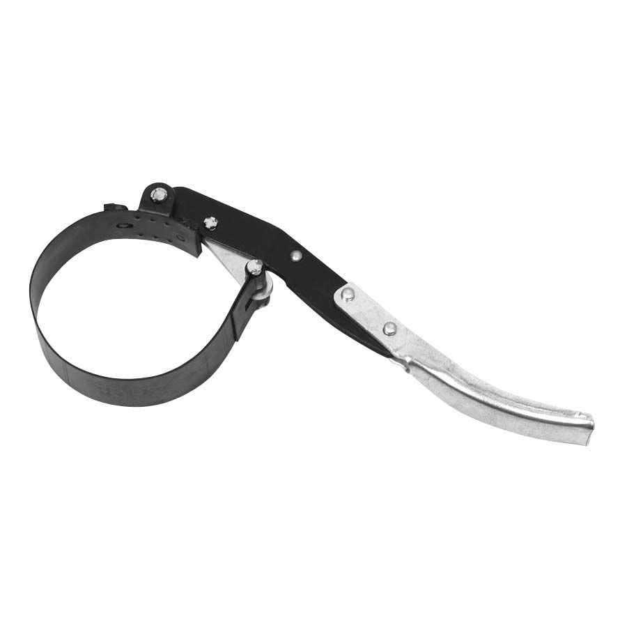

Here is a picture of the type Jon and I am talking about. I also use it to tighten it down as you can't get your hand in there well enough to get a grip. if you don't remove the oil line, then put the wrench on the filter before you spin it on. Then you just have to screw around for a minute to find the weird angle and you can get it off. I find it faster still than dealing with the oil line.
