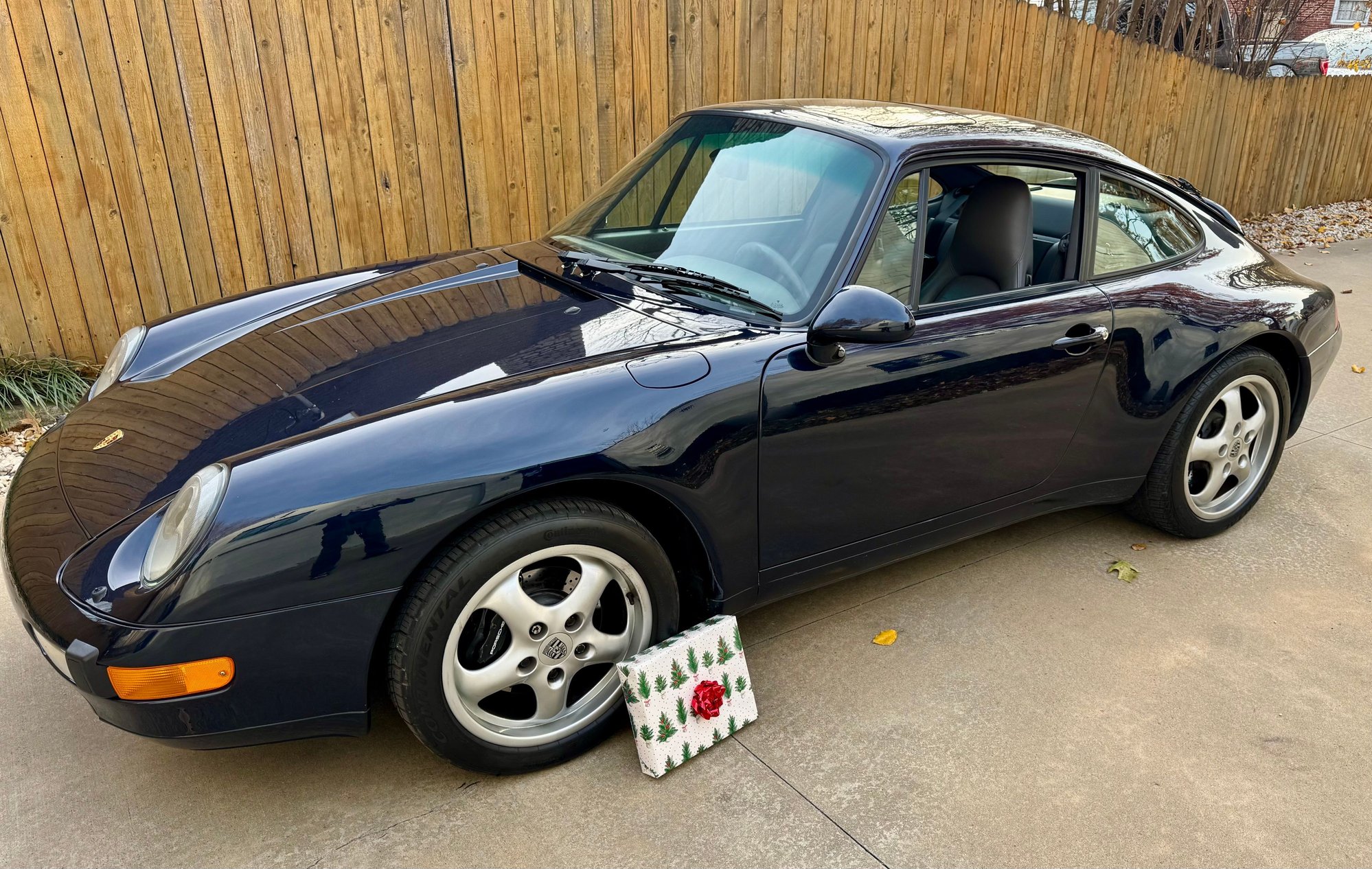

We also need some photos of your new to you 993.

Nice car. Congrats on that.
