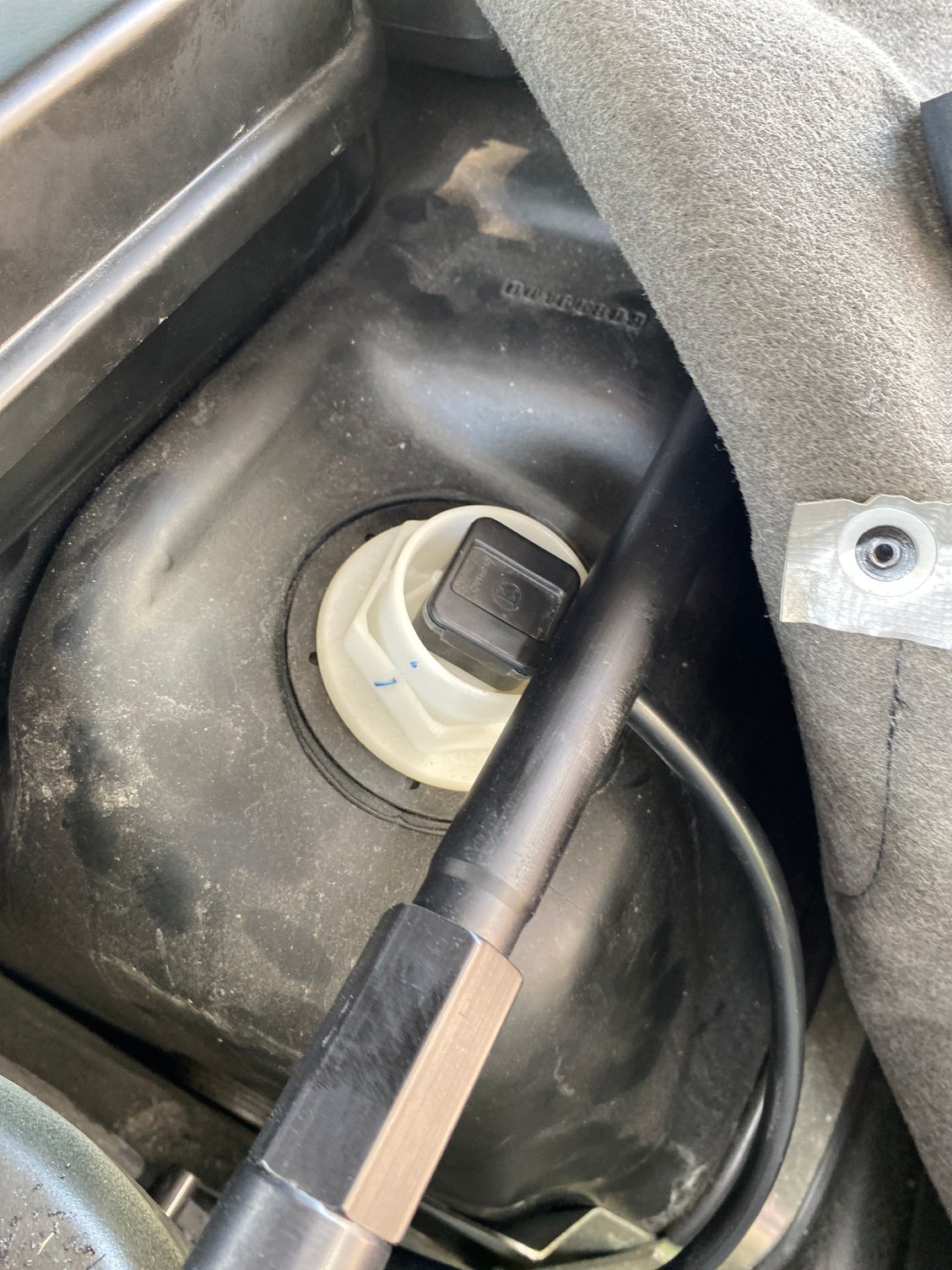

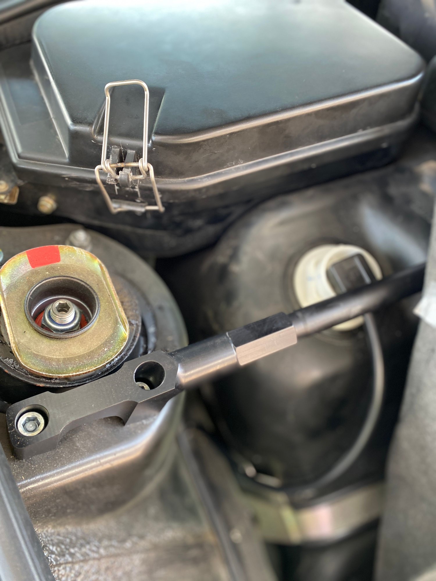

My 1997 993 C4S left headlight is still out. But strangely, first the replacement Xenon low beam failed, and after a couple of days, then the stock high beam also failed. I checked the fuses, replaced the low beam bulb, cleaned and checked all the connections to the headlight unit. Checked the ground wire. One thing I noticed was that the wire that leads up to near the fuse box is connewcte3d to a small black relay or something (I don't what the function of that small box is ... could be the cause of the problem?). And that lead that bundles into the main wiring harness seems like it might be kinked a bit.
Anybody know if that little black box up near the fuse box could be the source of the problem?

In my unending struggle to get my left headlight to work again, I've tried everything Rennlisters have suggested ...but so far, no cigar. I'm wondering what this little balck box does next to the fuse box . It seems to feed into the headlight wiring harness, and has a definate severe kink in it as it appears to head toward the headlight assembley itself. Possible cause of a headlight burning out one bulb and then another 2 days later? Photos attached.

Fuel tank sender.
