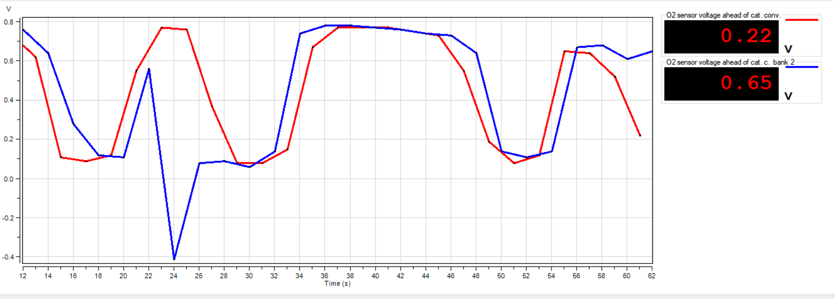

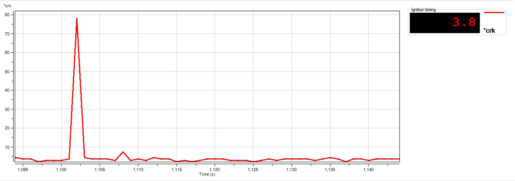

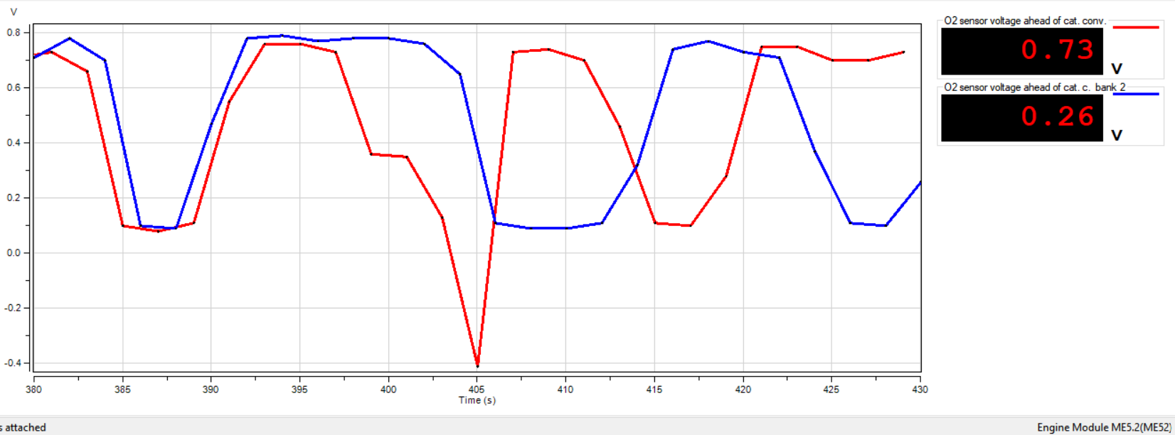

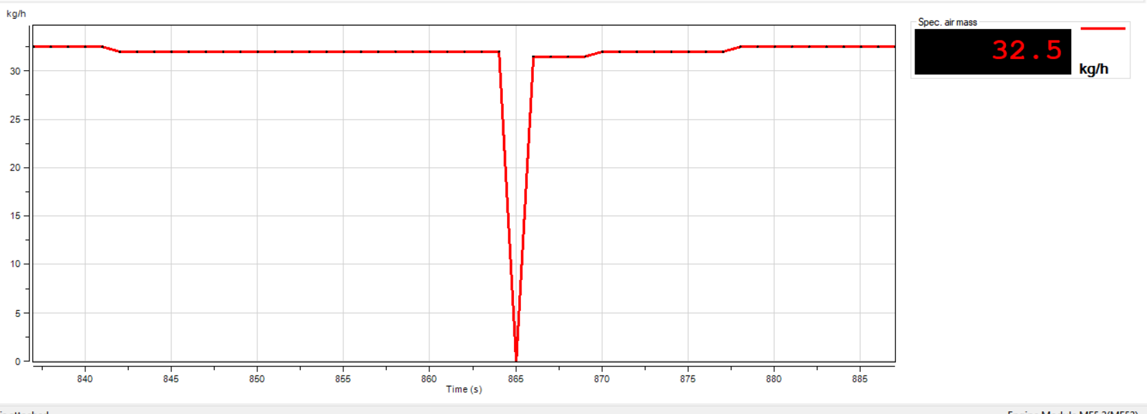

Bought a used Durametric cable on ebay this week.
There're sporadic glitches in most of the readings - either O2 sensor, MAF airflow, etc....
Is this normal? Related?

Check the actual data from the MAF sensor as it may have been bad out of the box as new.

Do the glitches on the scope correlate with rough running?
the fact you get 14.3v on the battery terminals says the ground from battery to chassis and starter/alternator to chassis are good. But there’s the hard to get to engine ground, the one that gets all the oil and road crud on it.
im with the crowd, it’s an electrical intermittent in the engine harness, most likely ground but worth checking all the engine wiring connector behind the rear blower. Disconnect them, squirt with electrical contact cleaner spray and reconnect, repeat a few times to wipe the contacts well.

MAF - this is a brand new MAF, and behaves the same as the original (which I'd also previously cleaned with MAF spray to no avail).
@IanM - hard to tell on correlation - need to play on the Durametric a bit more.
On my phone ODB app, I note that the RPM spikes are *positive* - up to 11k rpm or more whilst otherwise at idle(need to find time to check with the durametric tool). Wondering if this is significant and the cause of everything else going to zero)?
