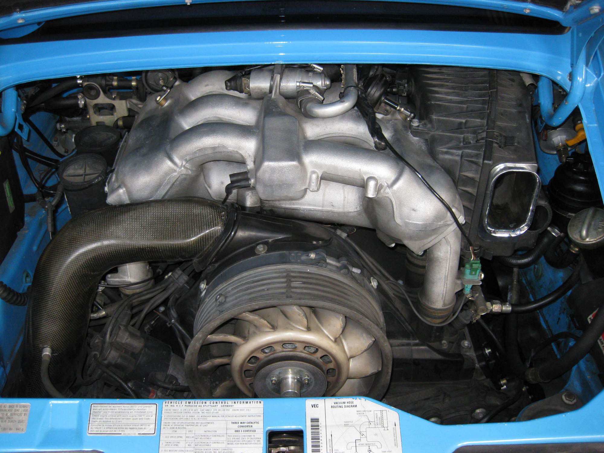

If you want vram you can have vram on a '95 and 3.8 or 4.0 etc, and far easier to chip tune the final setup
Here's what you get '95 3.8RS w/ custom chip and no immobilizer
