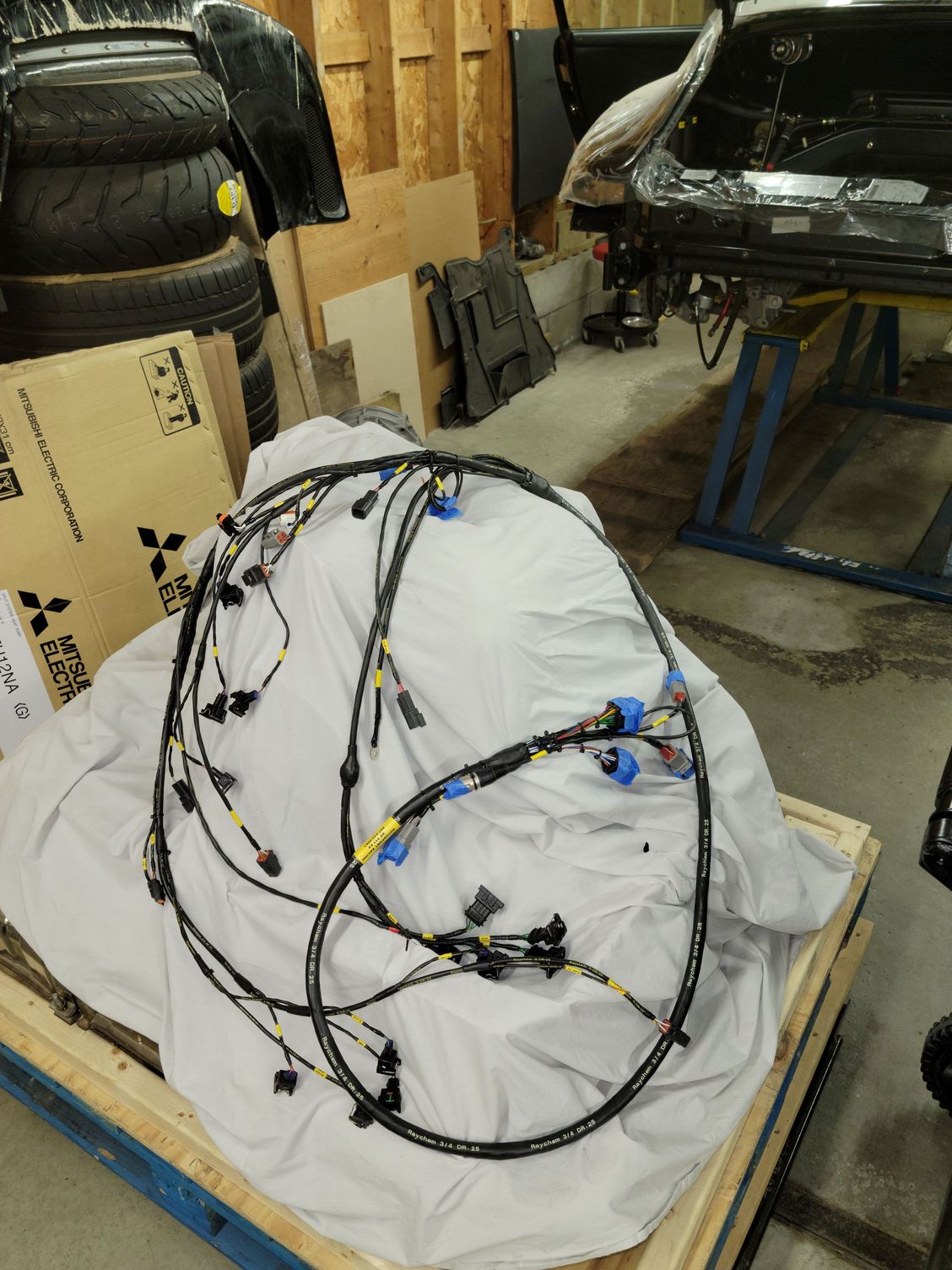

Got mine from Rothsport racing. Not inexpensive.
Designed for their 4L build components but you should be able use it with maybe a few connectors changes.
Note part number.
