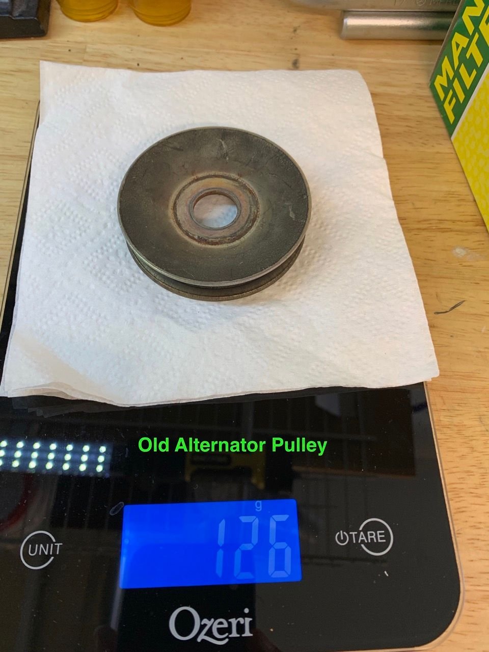

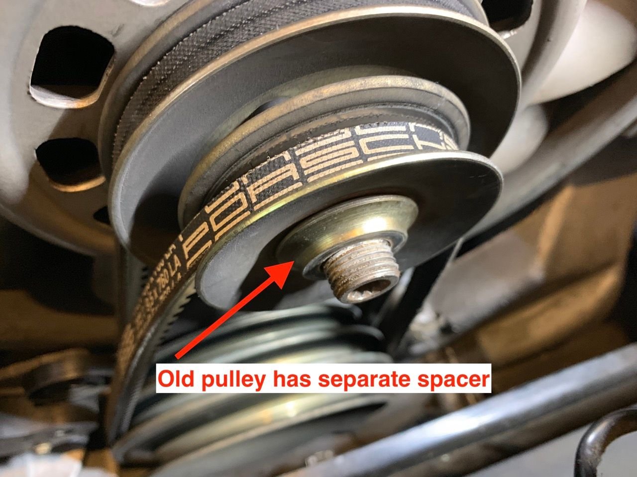

I think maybe I'd measure the existing tension first (double check belt part numbers) --- I would assume with only 600 miles on that alternator belt, that you would have at least 15-20 kg on there (cold).
BTW --- do you know if you have the old pulley or the updated pulley? See this TSB (pdf at the end of this post).
File Type: pdf
Old May 8, 2023 | 03:31 PM
  #58
flyweight's Avatar
flyweight
Joined: May 2022
Posts: 262
Likes: 52
From: Saratoga, CA
I think I have the new pulley. See attached.
Old May 8, 2023 | 03:57 PM
  #59
Jlaa's Avatar
Jlaa
Joined: May 2012
Posts: 1,157
Likes: 274
From: California
@flyweight that indeed is the updated alternator pulley and those indeed are the right belts. What's with that [aftermarket?] lockwasher? in front of the 24mm nut? That's not supposed to be there. Not sure if that lock washer affects anything at all .... I'm just surprised to see it there. You can see the 24mm nut is not engaging the shaft with all available threads either...... but I am not sure this has anything to do with your voltage/power issue.
Old May 8, 2023 | 04:04 PM
  #60
flyweight's Avatar
flyweight
Joined: May 2022
Posts: 262
Likes: 52
From: Saratoga, CA
Yeah I noticed the fit issue as well. No idea why it was there. I'll remove it. Thanks!
