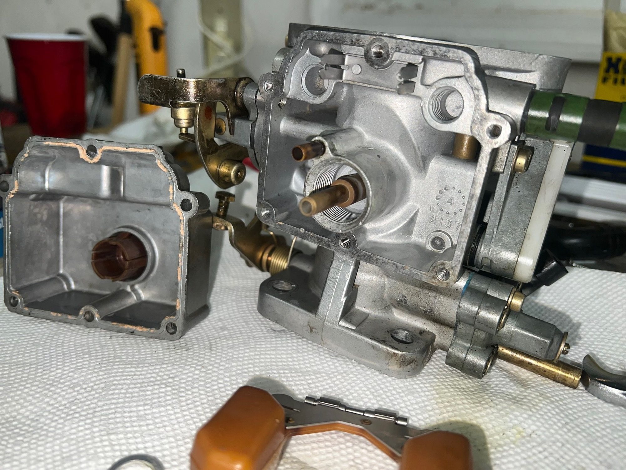

After some painful lessons, I settled on StaBil Marine 360 on a maintenance dose. Back in the Dark Ages, I used only MMO (for corrosion protection in steel fuel tanks...British stuff) and lead substitute where needed. At one point I had drivability issues on my very low mileage TR6 and pulled a carb after ~7 years since complete overhaul, the pic of the ethanol damage is below. At the same time, I was learning boating and folks recommended the StaBil Marine which I started using. The same carb was pulled after ~6 years of use (stuck float valve....piece of rubber from a recent but failing fuel line), that pic is below. Despite a sample size of exactly one, me, I was convinced of the effectiveness of StaBill. 1974 Tr6, pics at 42K and 48K miles, rear carburetor.
