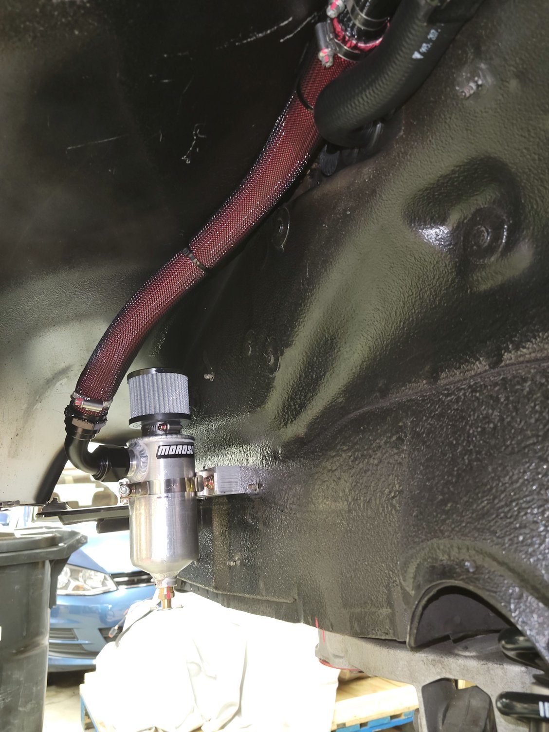

Oil expands with temp, without a proper warm up, overfills (1) are easy to do by interpreting the dipstick is reading low on oil that is not yet "hot". Then a spirted drive could uncover an overfill condition.
On my track 993, I have added an oil catch can in place of the oil to intake breather / vent (19). It is insightful how much oil vapor spirted driving will generate or how much a "full" oil tank can puke. I have come to see the purpose for proper dipstick level reading is to prevent overfill from the maintenance cycle variance in oil drain / change / refill (lots of variables), and then use dipstick to monitor oil level for use/loss (hopefully very little). Lubrication is more about pressure, oil quality, and staying above minimal volumes (don't starve pump) (15). Oil tank volume range can vary quite a bit and still achieve sufficient lubrication, the focus on getting the tank level right / sufficient is more about cooling / keeping the oil within its operating temperatures (6 & 7 & 17) (as to not break down chemically prematurely thus losing the lubrication benefits).
Not seen much in the forums on the topic, but an oil catch can "mod" could be added insurance to diminish the effects of / catch an oil change tank over fill, but one more thing to monitor / maintain.

Any pics of your catch can?
Mounting?
Thanks
Mounting?
Thanks
I have a similar catch can set up to Kevin's, on my 4 liter 993.
Mounted in the right rear wheel well.
