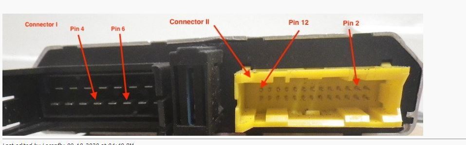

"Before you do any of this, make sure the inside of the ACU is clean and dry.
The wire you want to locate is on PIN 2 of the Yellow connector (II). It’s the only BR/GN wire going to the unit, so you can’t get the 'wrong' one. (BR/GN means Brown wire with Green tracer). That wire goes between the ACU and the immobilizer under the driver’s seat. When you press the FOB to UNLOCK the door, the immobilizer receives the radio command and pulses this line to ground. You’re going to simulate that by manually forcing that line to ground. You have to do this the ACU plugged in. What I would do is get your ground wire set up before you plug the ACU in so that you can quickly silence the beast. I’m not sure if you can get at the exposed pin at the connector or not. If you can, then get a length of scrap wire, connect one end to a good ground point on the car. Any bare metal on the chassis will work, and certainly the negative post on the battery will do as well.
With the ground end of the wire connected, plug the ACU in and just touch the other end of the wire to the ACU BR/GN wire. Nothing critical on how long you do this – the immobilizer pulses it low for 1/10th second so anything more than that will work. If you can’t get to the pin from the back of the connector when it’s plugged in, just strip a little insulation off the BR/GN wire and touch your ground wire to that bare spot. (Tape it up when you’re done).
That should silence the alarm. Then check if the FOB can lock and unlock the door.

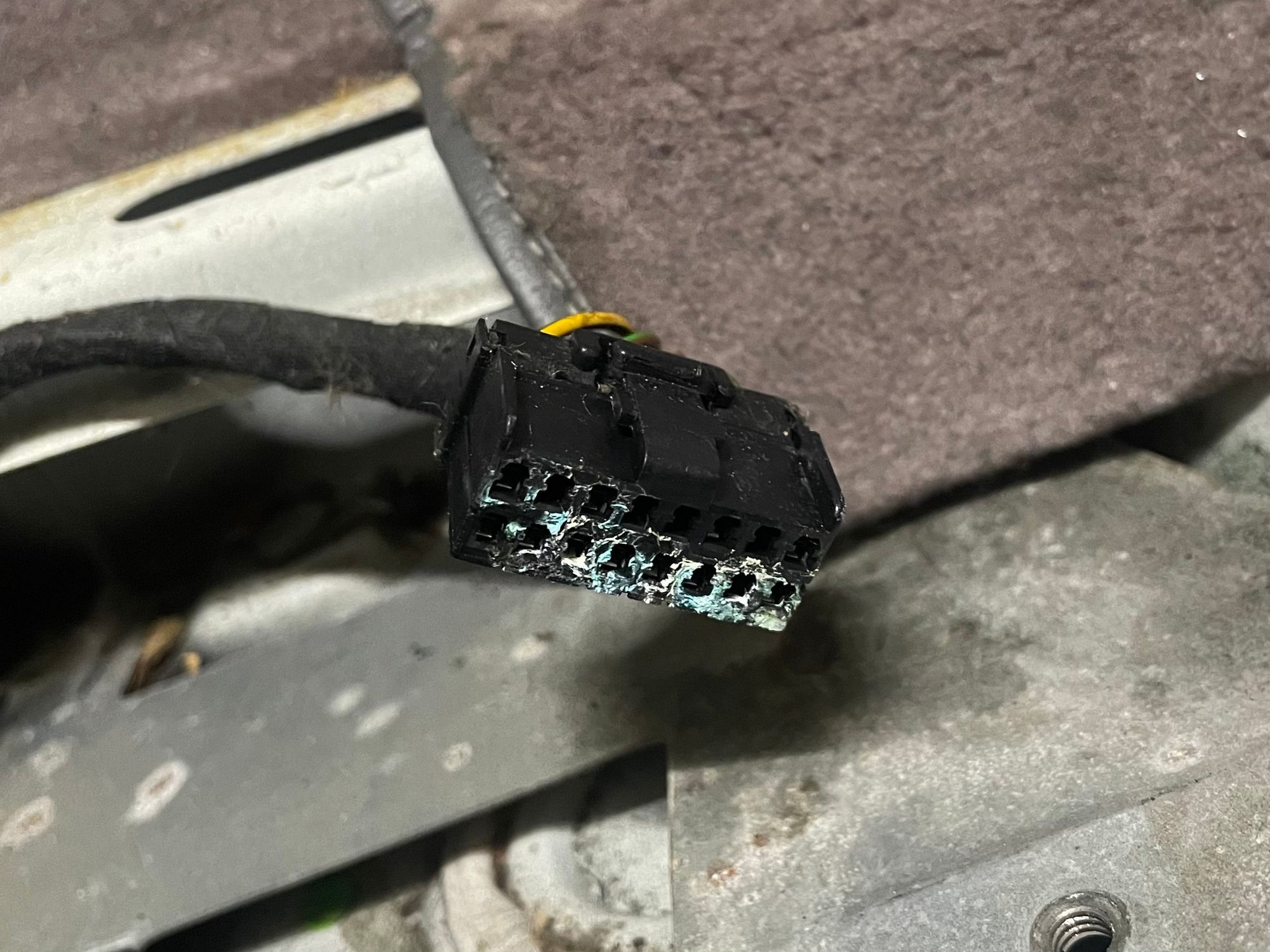

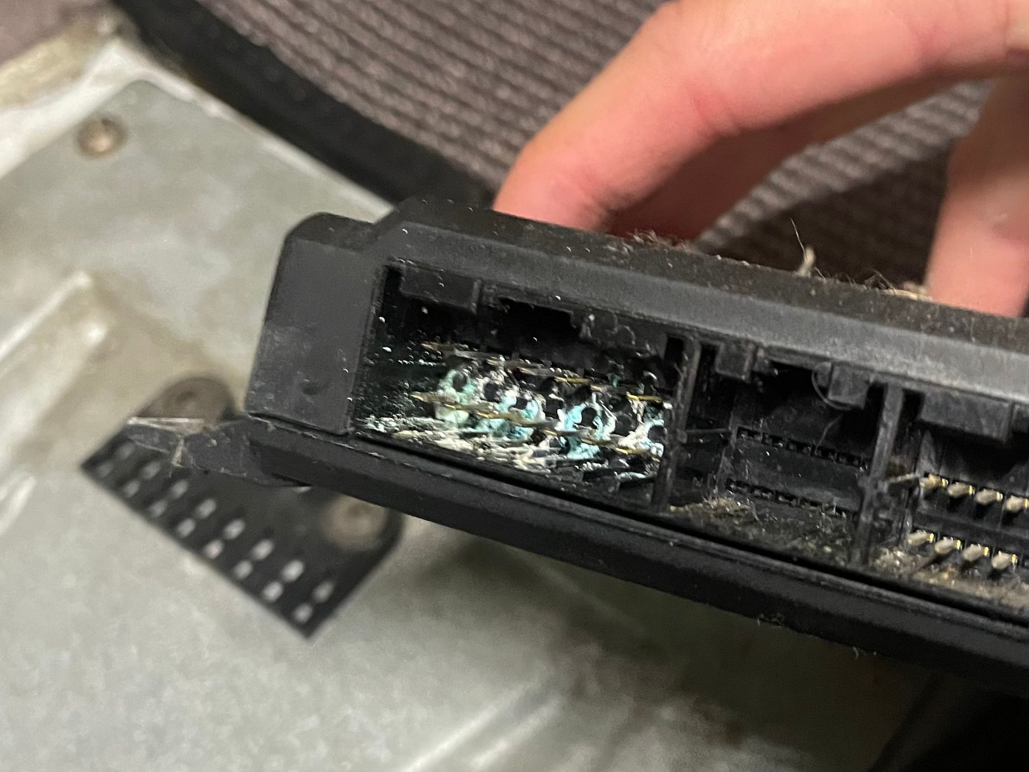

Default Update
Decided to remove my immobilizer to drop off with a friend to install the new caps mentioned in Jay’s past thread.
And… found the liquid damage:
Honestly surprised my FOBs worked at all. Everything will be properly cleaned up and upgraded.

Yeah, not good. From the recent spill? I've seen a few with the "green death", (mine included) but this has to be the worst. If you need some caps, let me know I keep them in stock.

@jay@EZimmoblock.com Yes it seems like it was from the recent spill because I cracked open the immobilizer case and the board looks ok; my friend will do a more thorough inspection. And thank you for the offer but I already purchased 5 of each and sent them directly to my friend's place so he can do the swap while I am out. I'll keep the spares on hand to offer to other owners I meet locally that happen to have the same range issue.

Update: Caps have been replaced per Jay's old thread and 'green death' has all been cleaned properly. With everything buttoned back up, my FOB range has improved from ~5 ft to ~30 ft (haven't had the chance to properly test in a large open space). Everything is functioning as it should.
