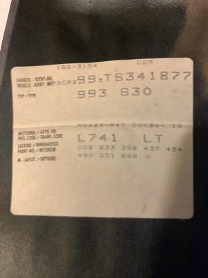

Are you 100% sure the option code sticker is authentic and not a replica? Post a pic. LT is black partial leather/black top.

Here's what I was sent.

I just found this on another thread entitled
"Accurate 993 Paint and Interior codes list" It's from 2011
"It's been discussed a number of times and well established that interior is _not_ described by a 2-letter code. There is a 3-letter/digit code for interior that is not printed on the underhood sticker. Do a search on this on Rennlist."
So, Maybe the 2 digit code is not determinative of the seats always?, This car has black carpet and black dash.

LT = all black interior with partial leather.
The car has had it's interior recovered. Those seats are not original.

I would say the seats were swapped as the photos show seats with "supple leather" option code 982 for the front seats and 939 for the rear seats which doesn't show on the sticker. You would also have option code Z69 for deviated carpet as Cashmere had Cashmere carpet as standard, so to get deviated black it would have the Z69 code. The sticker appears authentic.
