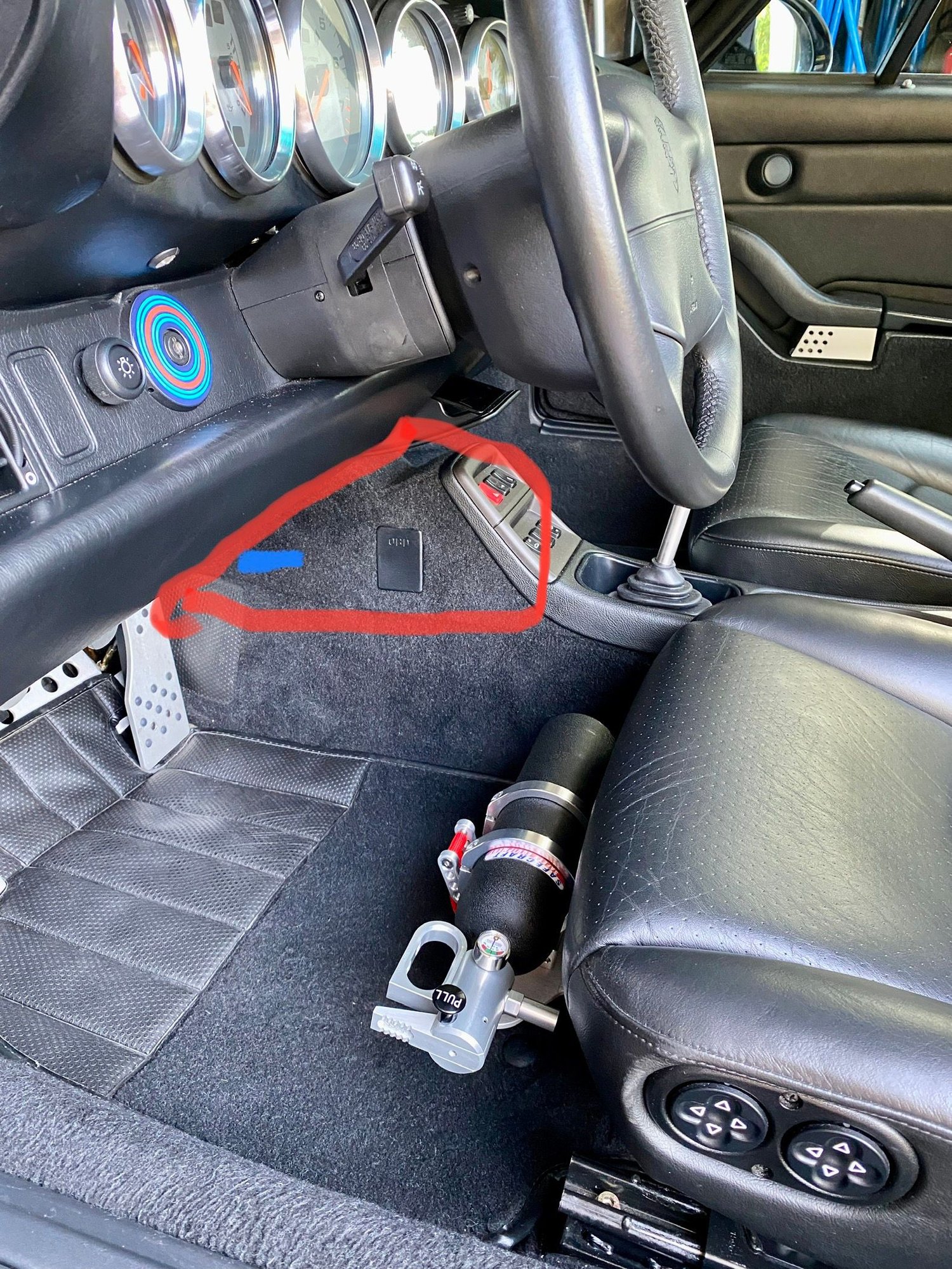

There may be some confusion here. Take your picture above and circle the part you want to remove and I can help from there.

Have had the plastic face, switches off already, but need to get to back-side of carpeted areas. Blue line indicates where the existing ABS plastic knock-outs are to install OEM courtesy lights, which I have in hand.

Gotcha. You're going to want to remove the whole console for that. So, separate the shift boot ring by pushing down on it. Remove screws in storage cubby behind hand brake. Unscrew frame from tunnel. Remove hand brake tray and screws under it. Remove entire console in 1 piece. Then take those side panels off. There are 2 screws per side if I remember correctly and it'll come out from the side facing you. Shouldn't take more than 15 mins to remove.
