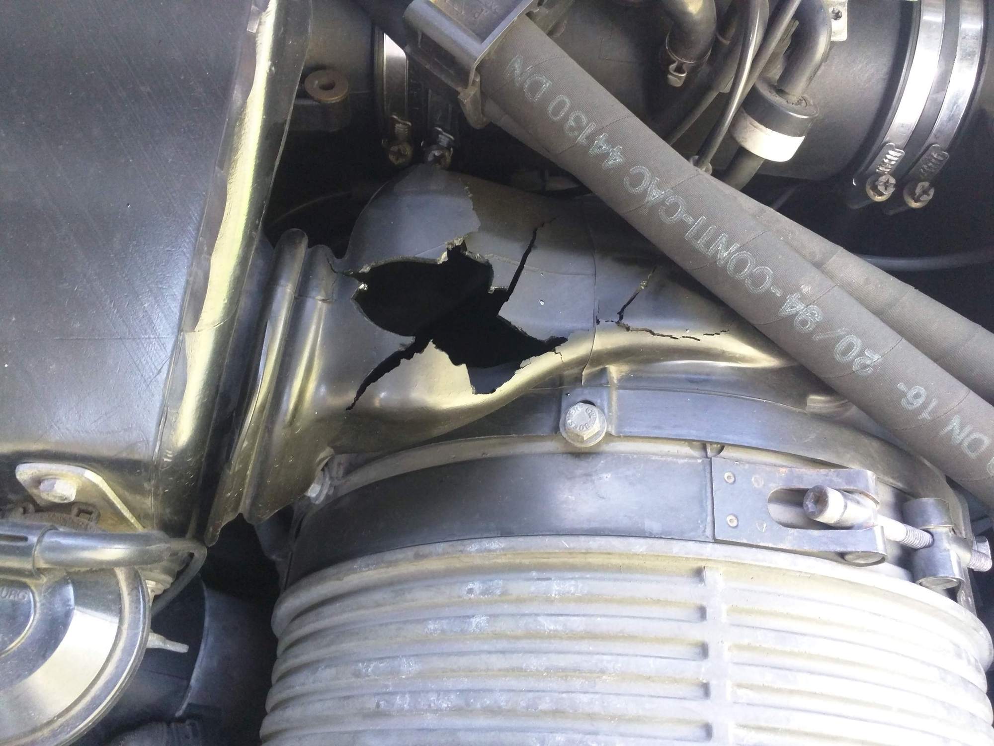

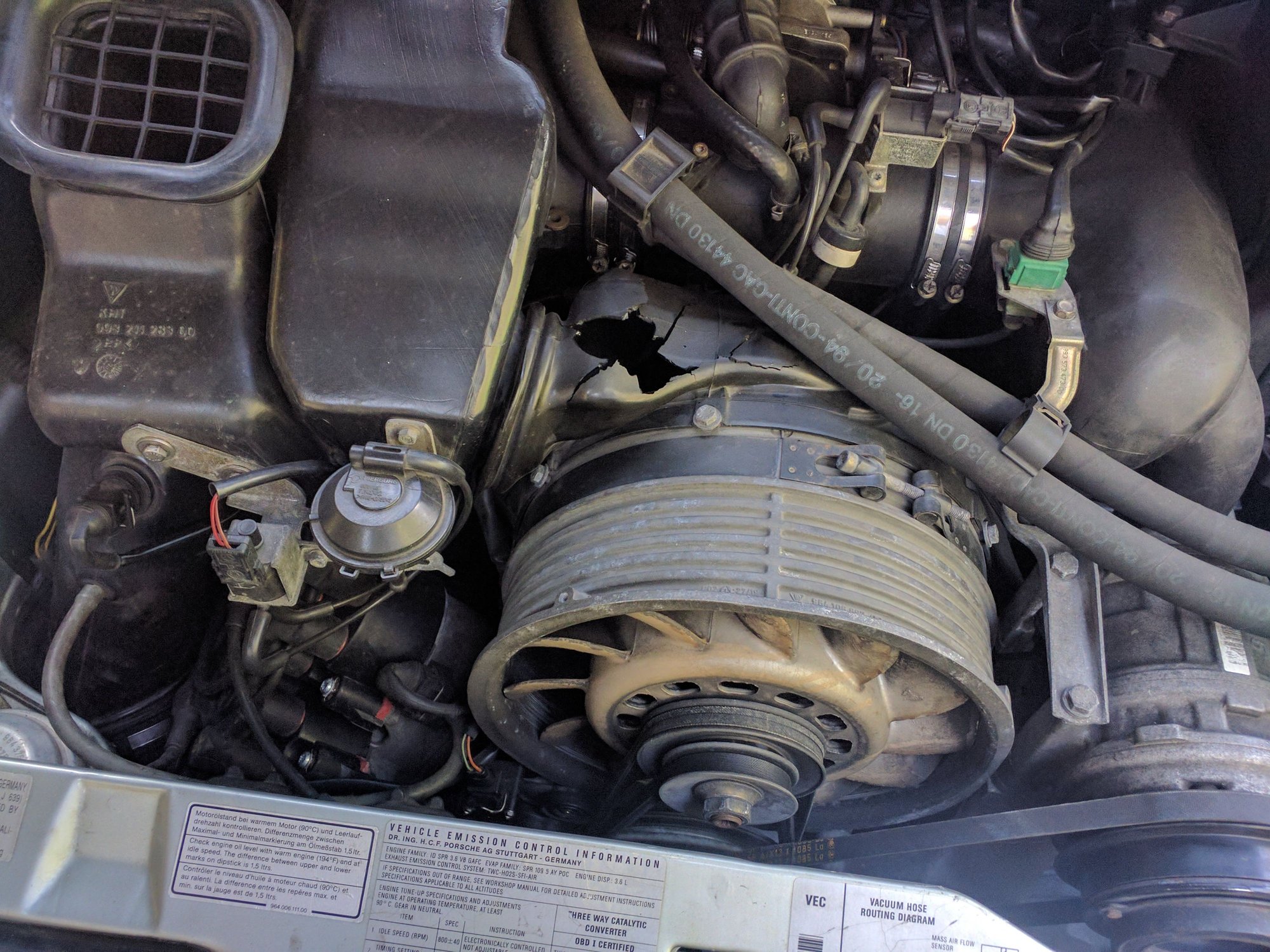

Opened up the engine lid today and noticed a gaping hole in the rubber piece attached to the fan and the blower/heater stuff.
As a really bad mechanic, will this be easy to fix or should I just take it in and pay somebody??

Easy day. It's a 1 on a 1-10 difficulty scale. 10mm socket and you're golden.

Thanks folks. I was away from home with the car and had visions that it was somehow connected to the entire circumference of the cooling fan.
Looked at the PET and looks easy enough.

Two parts for 1995. Early and late. Try to find a part number on yours to verify

Part number is located on the inside of of that duct.

You must have a late 95 going by the look of that blower. Order the one with 993 part number instead of 964
Based on the pictures from this previous thread, I will need the 993 part for my 9/94 build.

Exactly! You have the later blower assembly.
