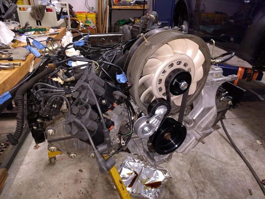

I wouldn't pressure wash any engine bay, especially with the engine in place. Too many opportunities to force water in places it shouldn't go - the electrical connectors, for instance, which are made to be weatherproof but not to stop a direct spray. It'd probably also demolish an original sound pad.
With the engine out, I used a spray bottle of 30% Oil Eater and water, and another spray bottle with fresh water to rinse, with an occasional light, low pressure flush from the hose. This easily took care of the spilled oil and PS fluid that accumulated on the pax side, and the dust and dirt elsewhere. Toothbrushes, q-tips, and rags are your friends, as is time. It's a slow job. Replace the sound pad (a huge PITA but worth it) and the place should look pretty good.
There's not too much to dispose, although the runoff is oily. Minimize that by first cleaning as much as possible with paper towels.
The Oil Eater mix is safe - I used the same mixture to clean the engine and parts. The fan, for instance, was filthy and came out looking almost new.

I'm both lazy and a slob, and would never pull an engine just for cleaning. I pulled the engine to take care of major maintenance items in preparation for driving the car a whole lot more. The cleaning was opportunistic. Mostly.
With fewer oil leaks I hope the engine bay will stay a little cleaner, and who knows - might even clean it again sometime.
