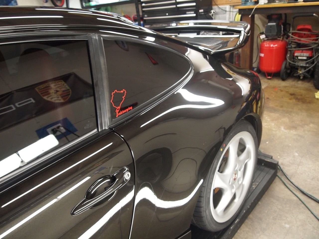

I have been using Zaino products for almost 15 years and think it's the best stuff out there. Best part, you can get this stuff on your trim and rubber, leaves no white residue and wipes of easy. http://www.zainostore.com/
If your paint has lots of scratches and swirl marks, I would clean the car, clay and start with this stuff http://www.zainostore.com/product/Z-PC.html (Note: If you are not getting the results due to heavy swirls or scratches I would try a more abrasive compound polish like the 3M kits, I have had good results with these 3M products when I do some color sanding.
3M Polishing Kit) 3M Polishing Kit)
Once you have all the swirls and scratches removed I would finish off by using Zaino Z-2 http://www.zainostore.com/product/Z-2.html Make sure you get the ZFX flash cure accelerator http://www.zainostore.com/product/ZFX.html This stuff actually makes a difference and works with Z-PC, Z-5 and Z-2.
Going forward once all the paint has been restored, I would maintain the car by using Z-5 http://www.zainostore.com/product/Z-5.html and Z-2 http://www.zainostore.com/product/Z-2.html. I swear by these products and the shine is insane. Make sure you follow their instructions. Here is are a few pictures on how it shines on my Metal Black 993. Good luck with whatever product you go with.
