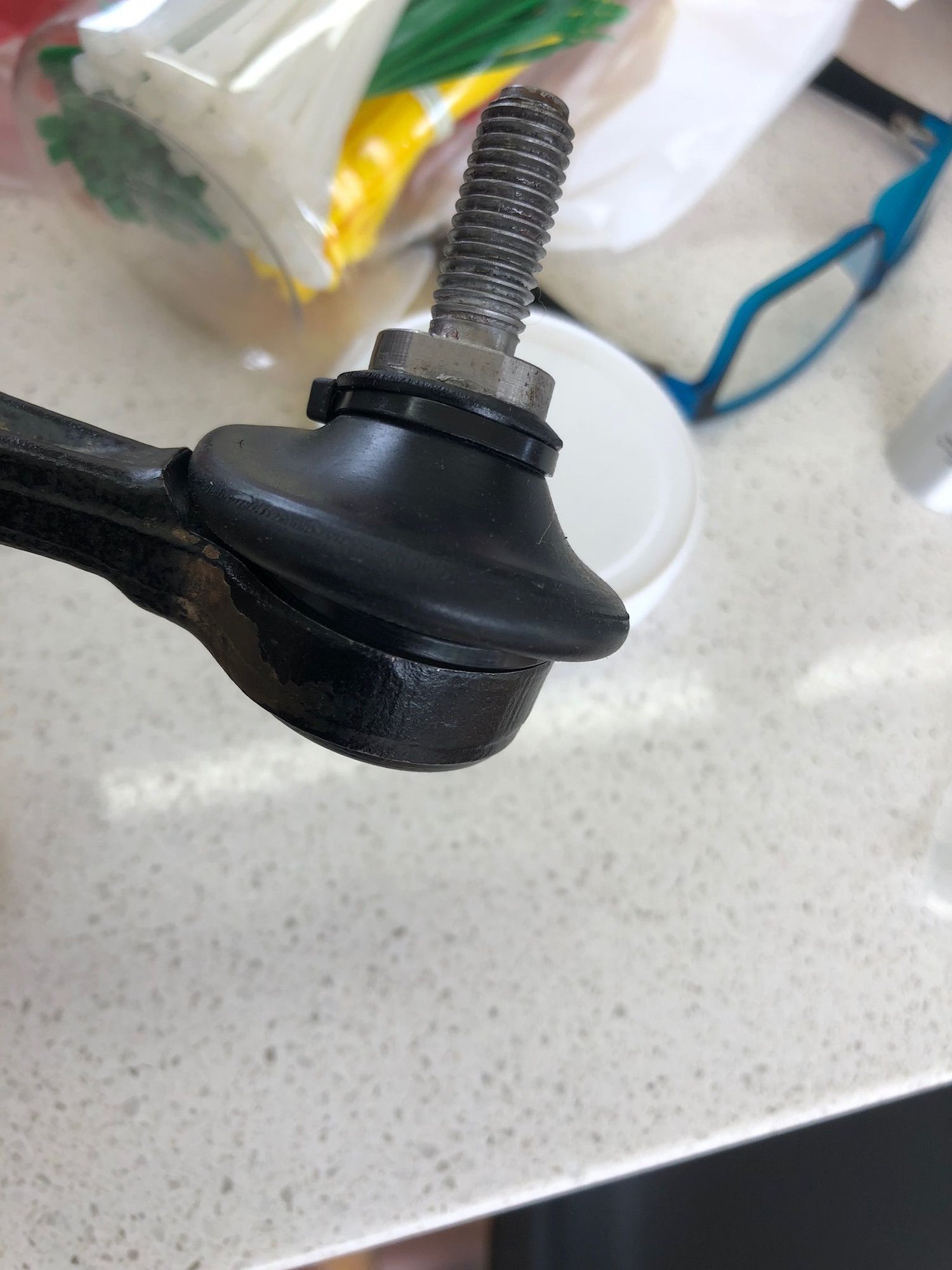

Old Mar 24, 2018 | 03:46 PM
s2racer's Avatar
s2racer
Joined: Aug 2002
Posts: 395
Likes: 18
From: St. Petersburg, Fla
...and here's what the replacement boots look like. As you can see, I haven't figured out how to get the retaining ring on yet, but fitment seems pretty good.
the size I ordered was 17x33x26mm from ebay/polyboots.com (no affiliation).
any suggestions for getting the ring on?
Marc
Old Mar 25, 2018 | 02:58 AM
Spokes's Avatar
Spokes
Joined: Dec 2012
Posts: 1,384
Likes: 357
From: NZL
Marc
I used ties. Both ties need to be no wider than 2mm, They fit nicely into the groove. Note these are droplinks on a 964.
