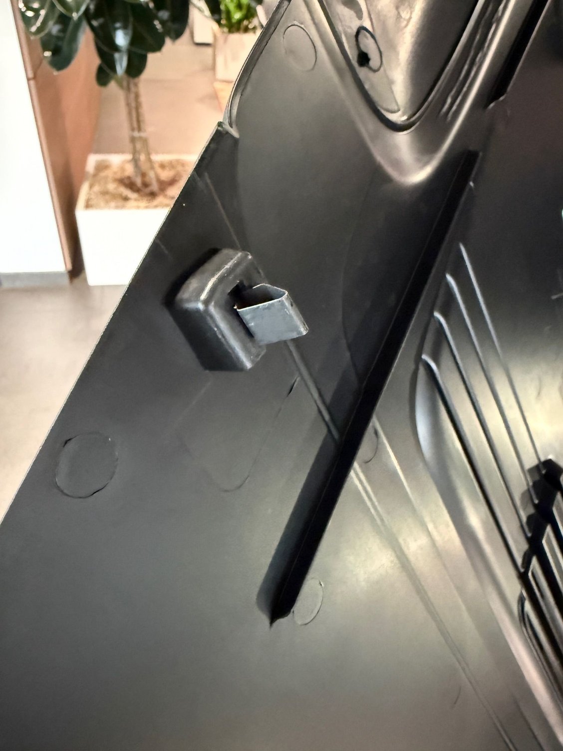

That is what I did , but then my dealer sent me that screenshot that made me doubt my process as the #3 clip sits below the front trim ( 992863475A OK1 COVER FOR LOCK CARRIER - MATT BLACK) which is #1 in the diagram.
Where our clip should sit below 992863081B OK1 COVER - MATT BLACK as you said which is 21 in the diagram.
Correct. When I look up a part, and while it would be nice if the images were accurate, they often are not. The images are at some level generic. So when the image seems a bit off from what the data describes, always go with the data.

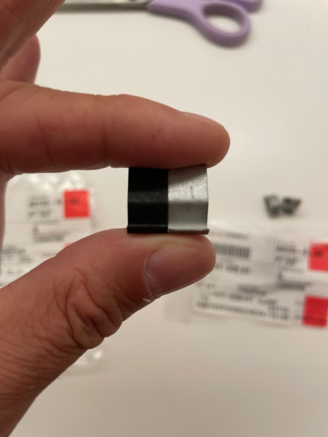

So now we know that those two clip p/n referenced here are identical and the right ones for the purpose of the missing frunk cover clip, (not the ones in the PEC drawings) except one is blackened and the other one is silver.

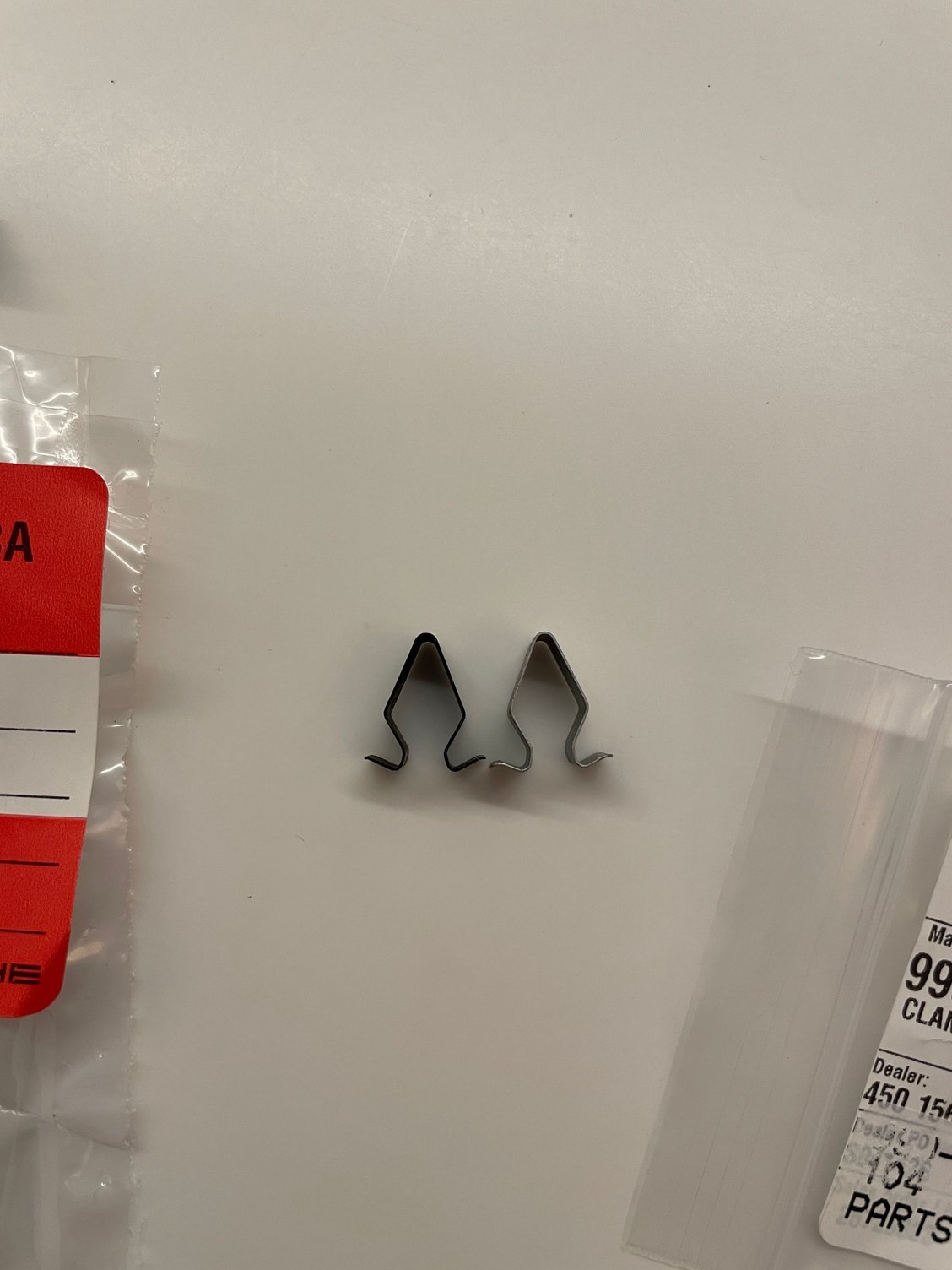

I purchased several of these clips. One was MIA and I figured if one had gotten legs it might not be the last one to do this.
Part Number 955-555-278-00 was the least expensive of the potential options. I paid $1.04 each. It also is exactly the same as the original that I still had.
The original clip is on the left and the new clip is on the right. The new clip appears to have a bit more tension, but otherwise they are identical and function identically.

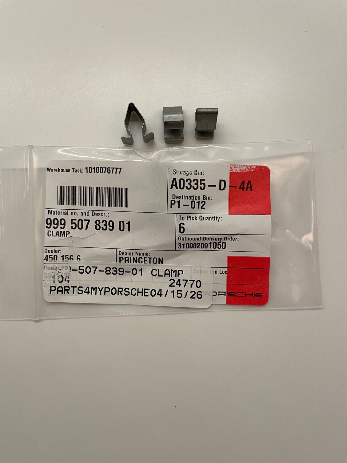

apparently these get misplaced all the time according to my service manager. Case in point, before I figured the part numbers, he reached out to tell me that he had found an errant clip on the “shop floor” and was saving it for me.
meanwhile I had ordered the two different part numbers to have extras:
Windshield Pillar Trim Clip Part # 999-507-839-01 $0.85 (black - matched what I had)
Windshield Pillar Trim Clip $6.36 Part # 955-555-278-00 $1.06 (silver - exists elsewhere in car)
and
PAF827649 of which I also ordered a couple of extras and is from some reason more than 10x more expensive but is identical to the other except for being a bit smaller is the clip that holds down the lateral pieces near the fender in the frunk.
