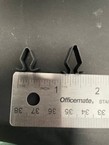

If anyone is still reading this thread and would like to help. Do dealer ordered the clip for me. I guess ordered the p/n I gave him so not his fault, but it's not the same one that was there before and does not clip as well as origin. see pics.
Does anyone know/can figure out this part number?
My dealer is super kind and tried to help but not great at figuring these things out.
[img alt="What I thought was the correct part according top the PETs on eurospares.
Smaller than the one that I need and went missing."]https://cimg6.ibsrv.net/gimg/rennlist.com-vbulletin/360x480/f7794bea_c561_43a8_bdd4_f185c680eebe_4_5005_c_00fae6f5fb33a00c692c937a18 2200ce7c74dec4.jpeg[/img]
What I thought was the correct part according top the PETs on eurospares. Smaller than the one that I need and went missing.
Left clip is what I received today. Clip on right is what was under my frunk and went missing on other side. Clip on right is what I need.
Clip on left in this picture is the one I need. Clip I ordered seems to be one size too small.

I am also missing one of the P/N PAF827649 Clips. So I read this thread with some interest.
I believe the replacement Clip is both OK and it's also different than the original.
Here is my theory. See the picture below. (FWIW, Thank you Photoshop.)
What I did was to trace the visible edge of the "new" clip (red) and then drop that trace on the visible image of the original clip. I had to rotate it a few degrees but that's it.
The business end of this design are it's hips (yellow arrows). The opposing ramps appear identical as well as all other shapes, with the exception of it's tip length.
I'm inclined to believe this is "technically" an acceptable revision to what is almost certainly a part that is used on other cars in Porsche's product line.
For all I know the reduction in the tip length may be an intentional design change.
The only downside I see is that it might make physically replacing the cover a bit more challenging. Aligning the Clips with their Sockets already being similar to what I imagine it would be like playing with a Ouija Board, blindfolded.

Than ks for sharing.
Thats what I figured as well.
That the parts are now "different"
Since I did place the "new" clip in place and it seems to fasten fine. Although it seems a bit less sturdy/tight but maybe thats in my head.
The manufacturer of these clips is either Nifco or ARaymond.
But I cant find a way to purchase.
But I also can't live with knowing I have two different clips. So I guess I need to get a matching "updated" model.
