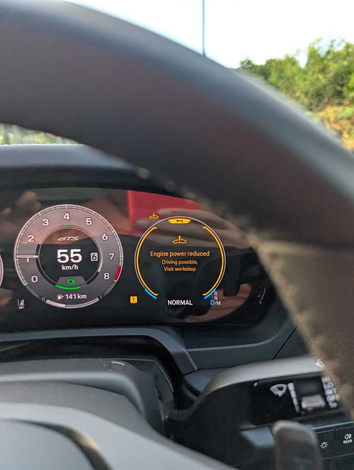

second drive after getting it back from workshop, it failed again with same error. this time under very slow and calm driving conditions. i hope mine is not a lemon...

Took delivery of mine one week ago and dropped it back off last Friday. Had 20ish error messages (all orange) coming up including 4wd error (RWD only), lights, ABS, transmission (reverse not possible), etc. etc. after my first longer drive (c. 150km)
Stopped the car and errors went away for a while and after they returned and stayed. Called the dealership and they told me to bring it in and told me this "waterfall" of errors trigger each other and they have to diagnose. The car was driving fine except for the cruise control which was no longer working (no reduced power or anything like that).
Will be abroad for a while and only picking back up at the end of the month and hope they get it sorted. Car is brilliant and bloody fast... but fun did not last too long
