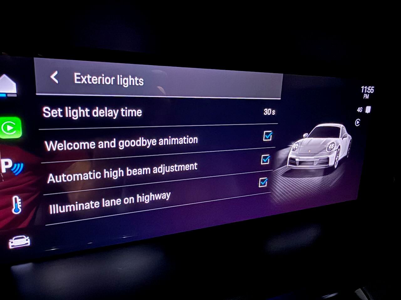

I got the HD Matrix activated on my 992.2 T a couple of days ago by @rnlst_log (Mars) with the help of @dixonk (Kevin) who supplied the power supply, PIWIS tablet, and VCI. A huge thank you to both for a smooth process in getting this done on my car. It was a bit of a gamble when I put the order in for the T in mid January with the HD Matrix lights optioned because the 992.2 light coding hadn't been cracked yet, but two weeks after the order went in, this thread was started. The process was the same as described above by @MartinHines and @vanlieremead . It's very satisfying to see the lights in action first hand since the videos don't it justice. I'm now looking for opportunities to take the long way home at night on the darker roads.
These are the menu items that are used to control the lights after the coding:
