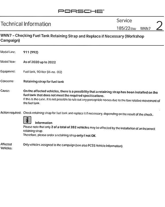

I have the Extended Range Fuel Tank on my 2021 C2S.
It has been to the dealer twice to repair the noise. Presently it is quiet.
I chose the option for several reasons: 1.) Why not. 2.) It allows me a bit of additional freedom to choose when and where to buy gasoline and 3.) With the volatility of gasoline prices, Dollar Cost Averaging can be your friend (I'm a cheap SOB).
Finally, I would not get this option again. The fixes that Porsche is using basically boil down to replacing the original foam mounting pads with thicker pads (see the attached). I'm of the opinion that the elasticity of the thicker pads doesn't really "fix" the problem, although it probably will extend the intervals between their replacements.
I've attached 1.) A copy of the Porsche Bulletin that addresses this issue, for those that may need it. 2.) Pictures of the second set of pads (used) and the latest third set of mounting pads (new) that have been used to correct this problem on my C2S. 3.) An audio file of the noise, which Porsche calls a "Popping" noise. Porsche wants an audio file from a dealer to verify that the complaint it real. The problem is that the popping noise can be intermittent and is dependent on how much gasoline is in the tank. The result being IMHO an unnecessary delay for everyone involved and places hoops in the way for the dealer to jump through to get this fixed. Feel free to share this audio file with your dealer if/when you encounter this sort of nonsense.
