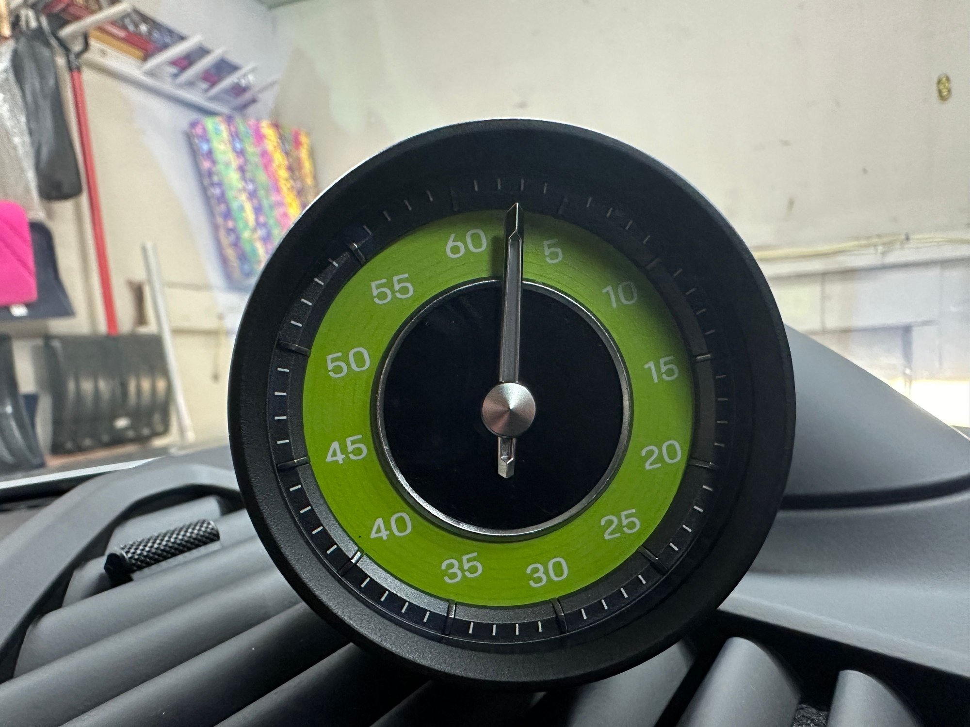

I just did it. Installation was not too bad. However, I could not align the needle back at 12 position. It is 3 seconds ahead. Any idea how to fix it? Thanks
Did you disable the clock BEFORE you started the mod making sure the needle was properly aligned at 12 o'clock? Not sure doing it now will help but it's worth a try. Disable and re-enable see if that helps. GL

I did, not sure why. However, I removed the needle, plug it in and “turn off the clock”, and put back the needle. It works! Thanks

I just did it - but my clock's needle rests at same position as your's when the car is turned off - isn't it supposed to rest at 60?
