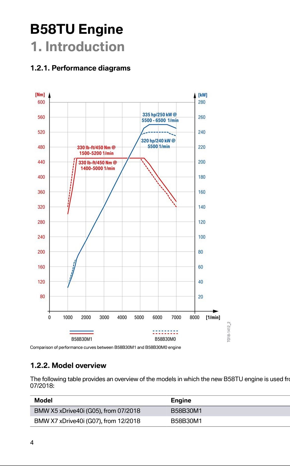

The BMW B58 has a variant where the turbo bolts directly to the cylinder head. They sacrifice 15 peak HP for torque that arrives 100rpm sooner.

There's a lot more to a proper manifold that just length of the flow paths Many companies went to manifolds integrated into the head for a number of reasons, but they kill high flow and therefore power. The mani integrated into the heads are basically log manifolds. They do save costs, weight, and reduce the time for engine warmup which reduces emissions and fuel consumption, all things OEMs like. But as everyone has seen on the B58 engine, the variant with a traditional head and exhaust manifold (non-integrated) has way more power potential.
