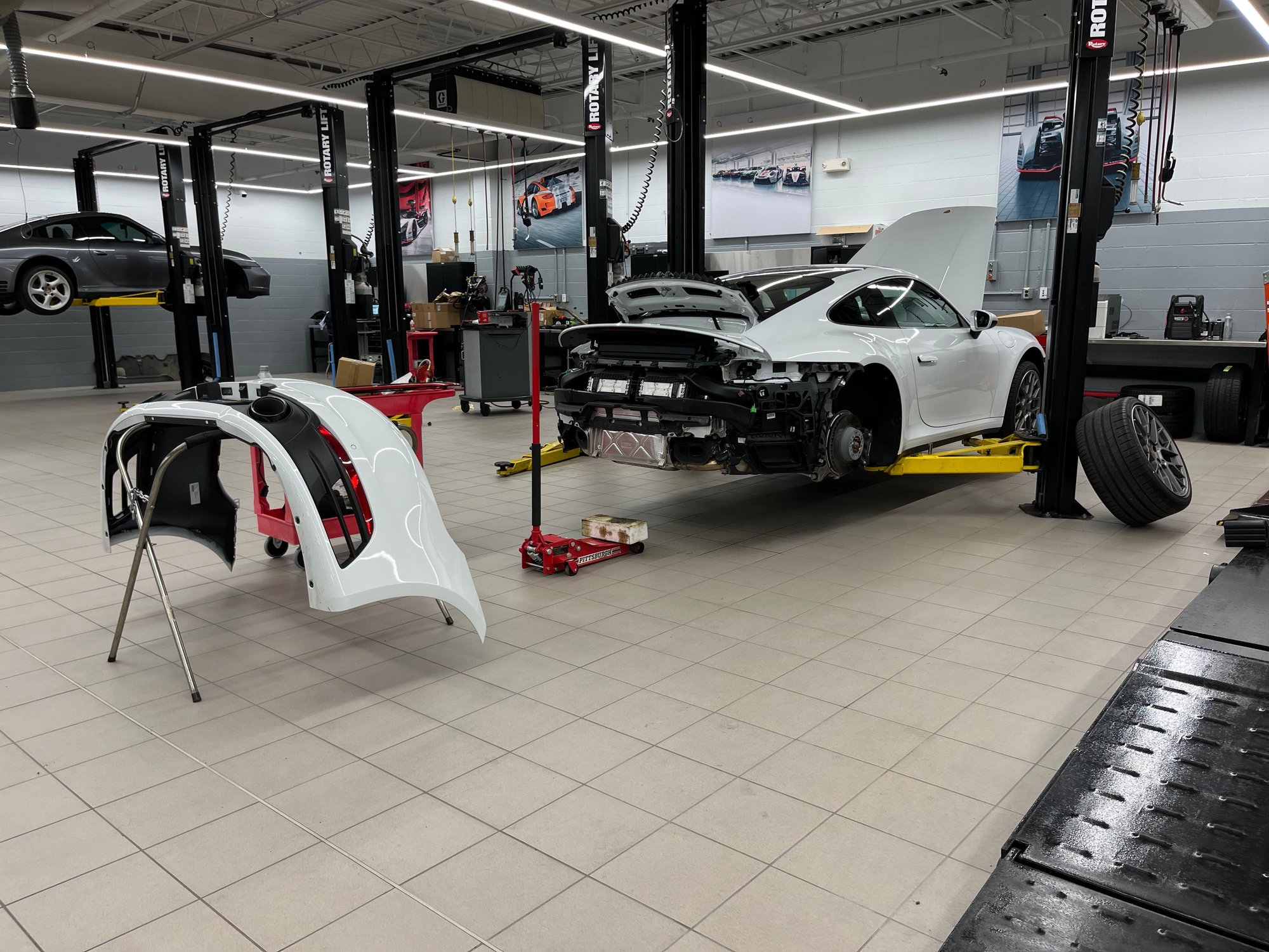

My 2023 992C2 is now in the shop with 300 miles on it, brand new car. I have a vibration between 1500-2000 RPM that was also diagnosed as Engine Mounts. Car is being repaired as we speak. I'll post an update if it clears up. The dealer did test my car against another in the shop to validate the noise was an actual concern... I was totally expecting to hear "it's normal for a 911".

I took the tech for a drive, he didn't acknowledge anything during the drive other than he heard the noise I was experiencing. Later that week they called back and said they drove another 992 C2S that was in the shop and it didn't make the same noise. After some diagnosing they narrowed it down to engine mounts and said that Porsche also agreed it was likely the cause.
Car is still in the shop, close to 2 weeks now from when I dropped it off... not sure why it's taking this long but I'll be sure to post an update as soon as I get the car back.
It's unfortunate that this is a "normal" noise from some dealers. It really drives me nuts... reminds me of 3" exhaust systems I would put on my Civics years ago that wouldn't quite properly fit over the axle and cause vibration noises haha.

I really hope they address this issue, and that others can get help with their cars. I'm still waiting, looks like it's close to being ready.
992carrerabase on IG if you want to follow the updates
