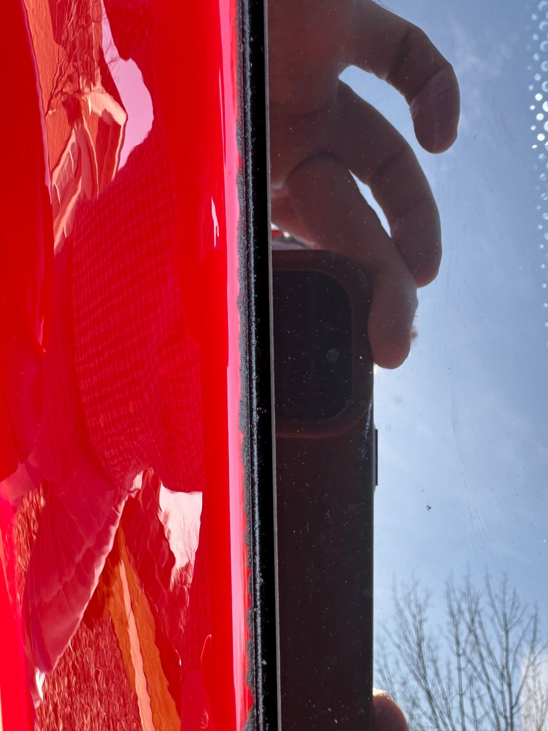

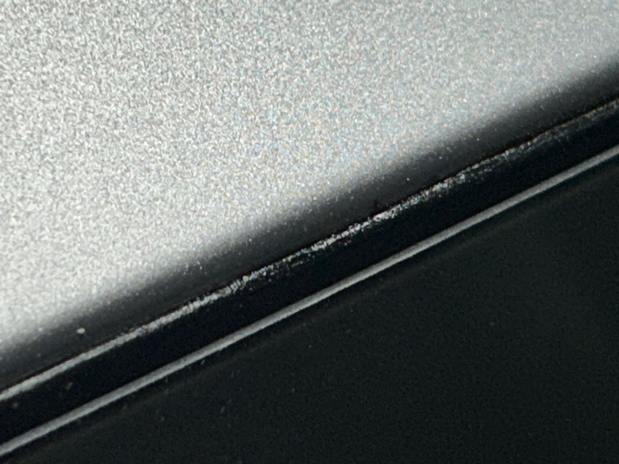

My 2022 C2S is having the windshield replaced at the dealer for this issue. Covered under warranty.
Here is a before pic. The seal is deteriorating. It is bubbled and sticky.
I'll post an after when I get the car back.
They are also putting on a new set of Michelin Pilot Sport 4S! Going to be a fun weekend.

I got my car back from dealer yesterday afternoon. This is what the brand new seal looks like. It is smooth and almost looks like a preformed gasket.
