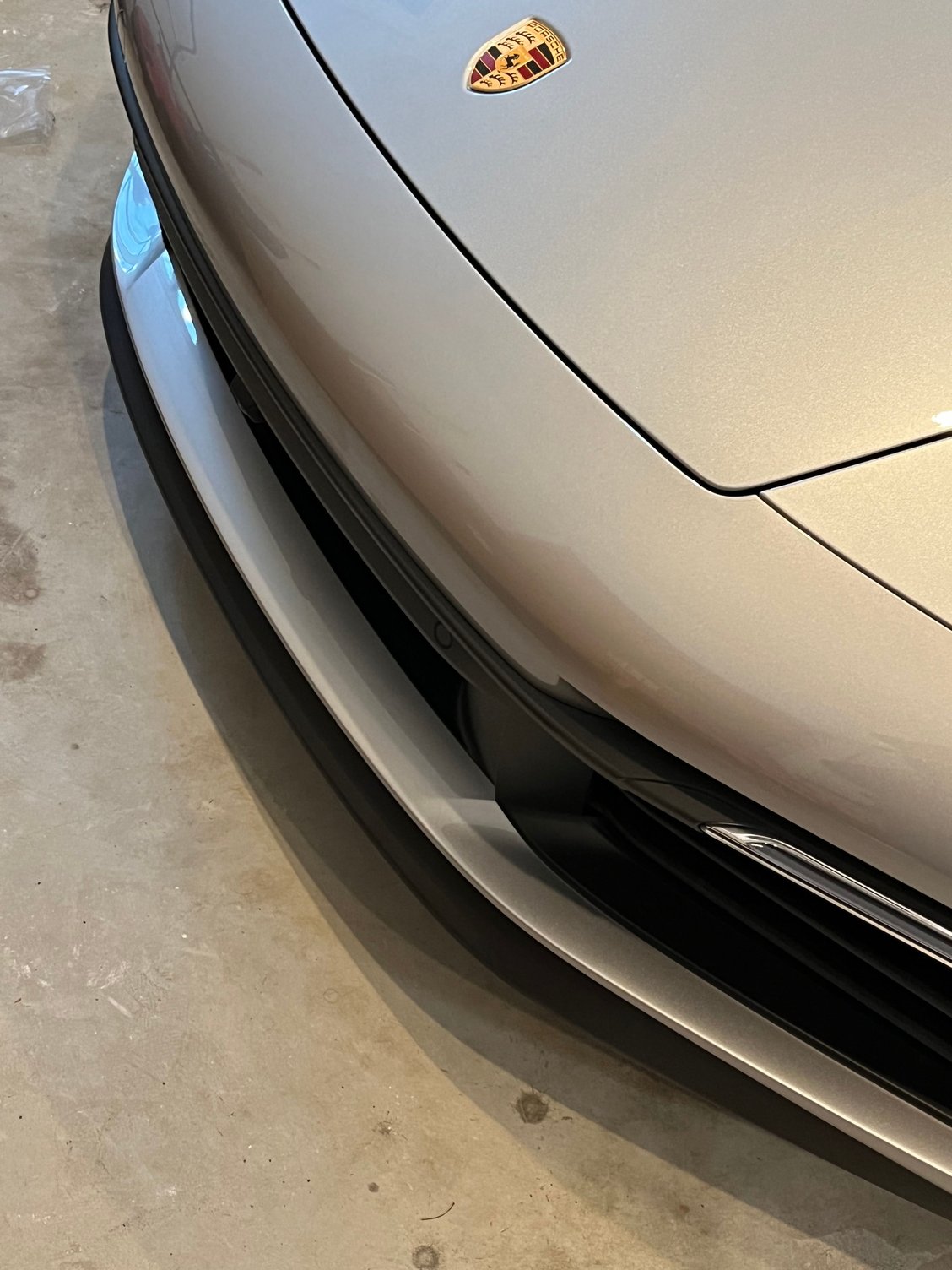

i intend to change my 992 Carrera front lip to the SPASM front lip of the GTS models.
but I have the standard bumper, not the sport bumper ( see pic )
Does anyone of you did that before? is it a plug and play thing?
the pic is not my car, but the front lip is what I want, I like it more than the standard lip of the 992 Carrera.
thanks for any kind of info
Ralph

Originally Posted by Ralph111
Hi 992 lovers
Ralph
Pic is my old car. Now, in the care of @DButcher . 👍
Yes, it’s an easy install, but if your car doesn’t have SPASM, there are reports of issues at speed. For most folks that isn’t an issue, but I am the cautious type when it comes to aero.
Ha, I was going to say I thought that was your pic. The front lip makes such a huge difference when you compare to seeing one without it.
