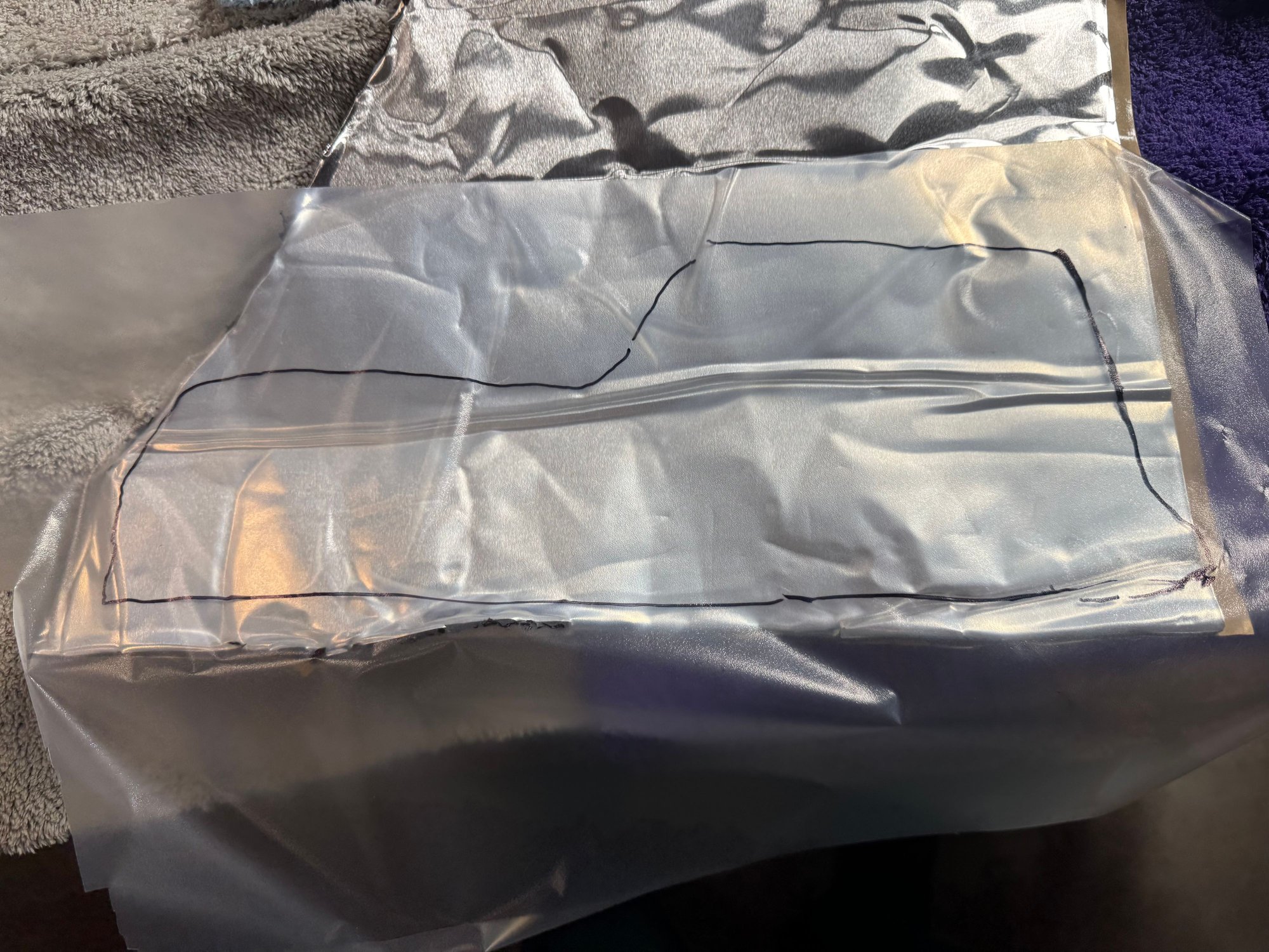

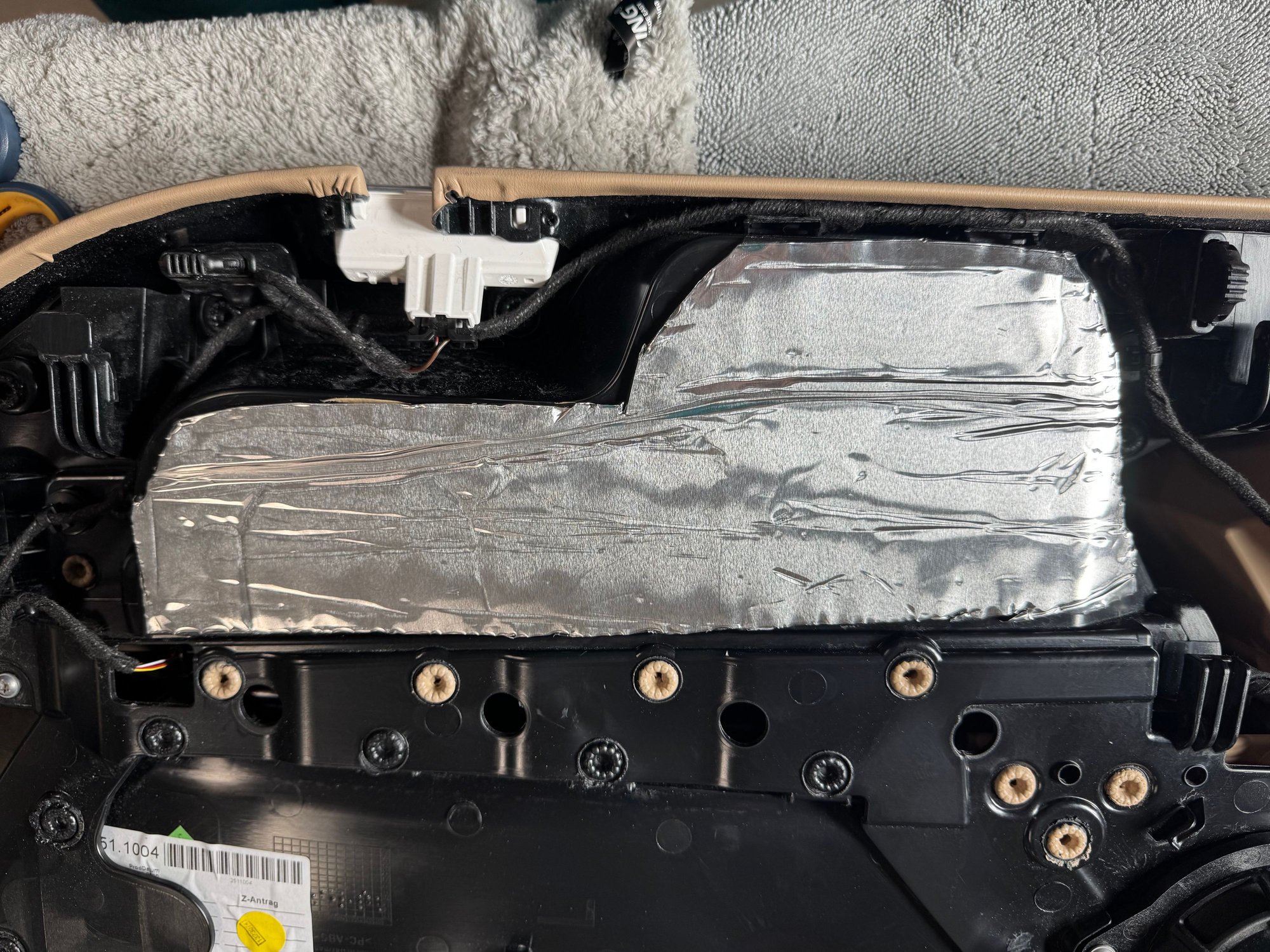

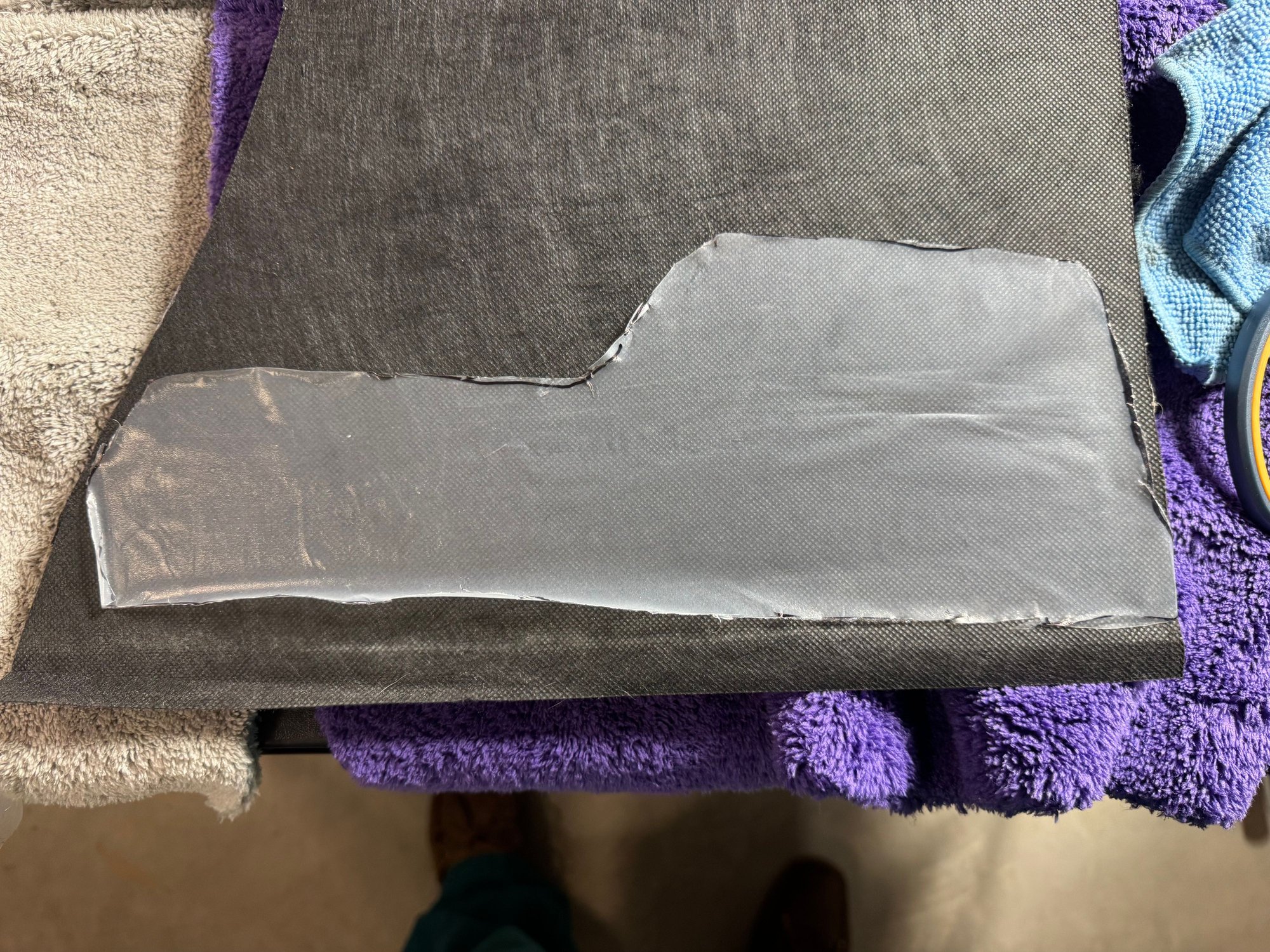

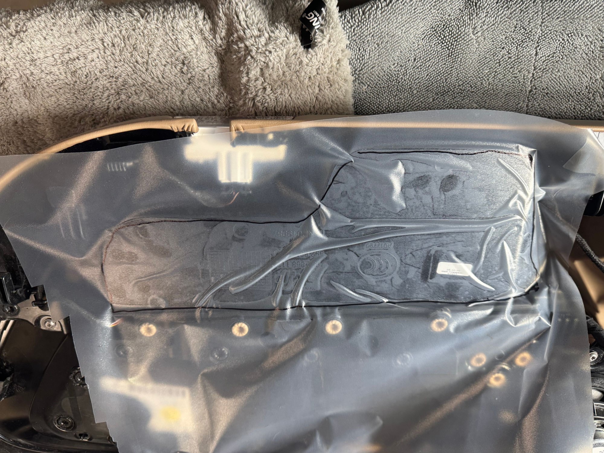

Just to follow up on this, I came up with an alternative method that I thought I'd share - it's best if you're doing 2 layers of something like CLD + a absorbing layer. When I did the first side of the car, I just cut templates out of the paper that comes with the CLD. It isn't difficult but it eats up time. I saved at least an hour or two by doing the other side with transfer paper and made MUCH better templates.
1) Use clear transfer tape and apply a layer to the surface you're going to sound deaden.
2) Take a sharpie and trace out the outline
3) Peel that transfer paper off and put it on your CLD.
4) Cut out your CLD with the transfer paper on it.
5) Peel off the transfer paper template and apply this to your second layer (I used Resonix fiber mat).
6) Cut out your sound absorber / fiber mat using the transfer paper template.
7) Stick on CLD
8) Stick on fiber mat / second layer
IMO the best part of this is that you can stick the transfer paper down into crevices and, since it's transparent, you can see underneath. So if there's a door hangar clip / wire bundle / etc that you're trying to avoid, you can go right up to the edge of it. I'll post a pic if it's unclear or anyone wants more info.

Pictures for those interested

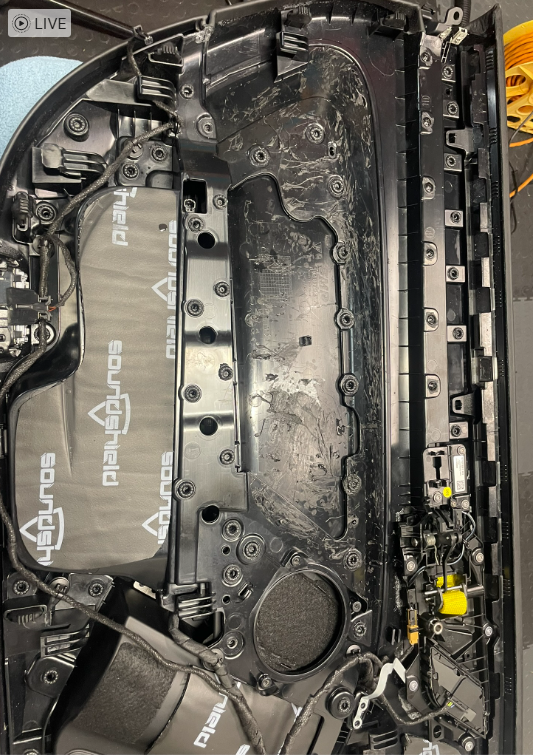

Here are the 4 pieces that you get when you buy pre-cut set from 12V Nick. Since this pic I updated my door cards 3 times and he always helps me getting replacement pieces.
here a pic with # 1 removed during door upgrade - luckily its not that hard to remove as I feared it would be. So, no worries adding insulation and not sure if you need to remove it again for some reason.
