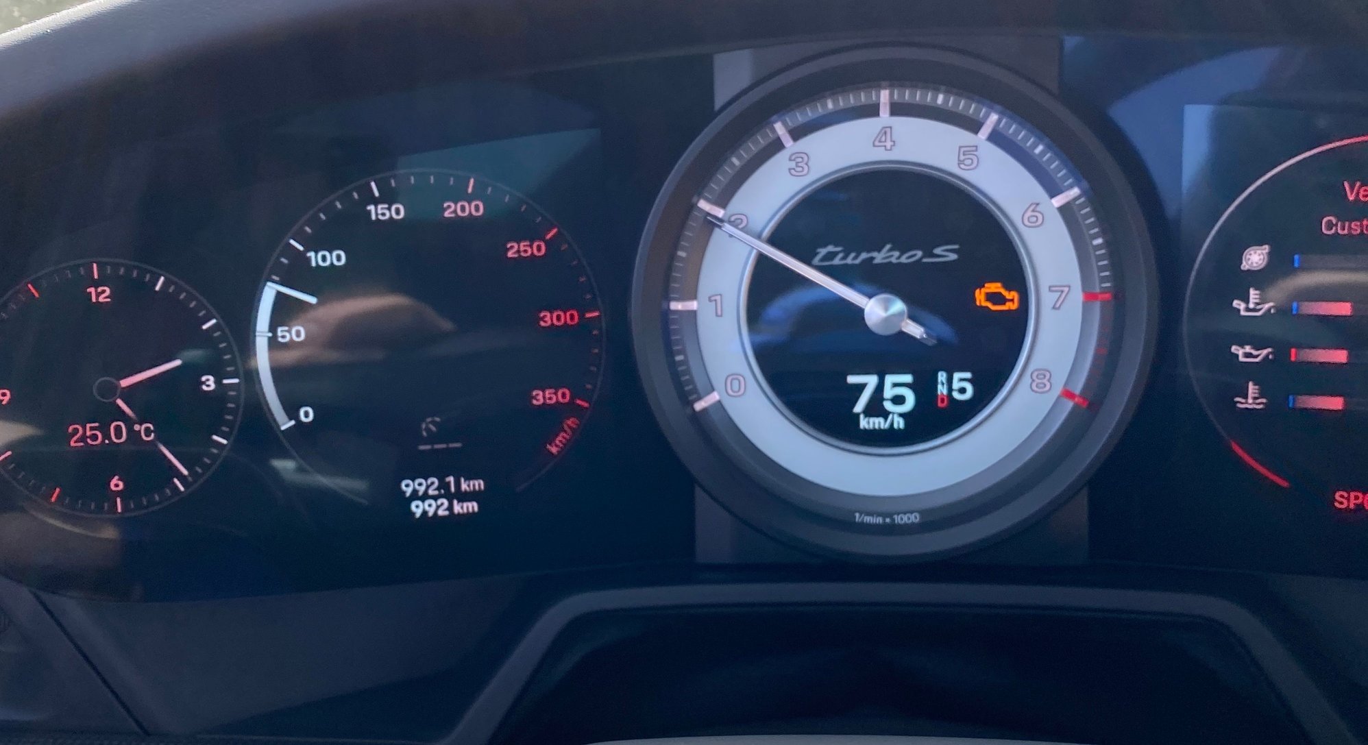

NVRANUF's Avatar
NVRANUF
Joined: Sep 2002
Posts: 4,165
Likes: 506
From: In a van down by the Ottawa River ...
Originally Posted by 1Gunner
To the folks that experienced CEL issues with their Soul Sport cats, was your car past the break-in period?
I installed Soul sport cats with just 11 "delivery" miles on the odo and I now have ~600 easy break-in miles logged and thankfully no CEL light.
Well dammit...... I spoke to F*#$'ing soon!

Soul Performance's Avatar
Soul Performance
Basic Sponsor
Joined: Jun 2017
Posts: 4,343
Likes: 2,179
From: Willow Grove, PA
While we have your spacers heading out Tuesday, I have take a moment to say superb timing on your photo at 992 kilometers haha

NVRANUF's Avatar
NVRANUF
Joined: Sep 2002
Posts: 4,165
Likes: 506
Regards,
John
Thanks John, looks like they won't arrive until next week.
  1. Is it ok to drive with the CEL on and before spacers get installed?
  2. Will the CEL self-clear after spacers are installed?
Old Apr 16, 2021 | 10:45 AM
  #75
Soul Performance
Basic Sponsor
Joined: Jun 2017
Posts: 4,343
Likes: 2,179
Assuming the CEL is on for P04200 and P04300 catalyst inefficiency, yes you can drive the car as if the CEL were not on. We have seen the CEL clear itself with and without the spacers over varying mileage, we have also seen owners that do not want to wait for the CEL to turn off and go clear the codes. If yours does not clear in a few drive cycles, I would recommend a reset.
Regards,
John Gaydos
