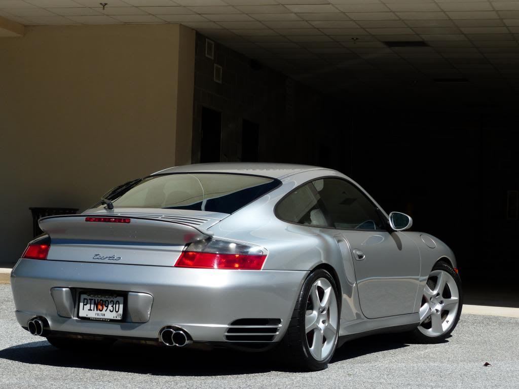

FWIW, I had a 2002 996 Turbo X50 awhile ago. The $2300 optional wheel upgrade was to the 18" Sport Techno. This wheel was the same for narrow body (Carrera) and widebody (Turbo). From the factory it was delivered with 15mm (rear) and 8mm (front) spacers. So Porsche's engineers and the TUV, which certified this setup) thought they were a good solution up to 190+ mph.
Of course, I couldn't be content and switched to 30mm rear and 15mm front. Just right!.
