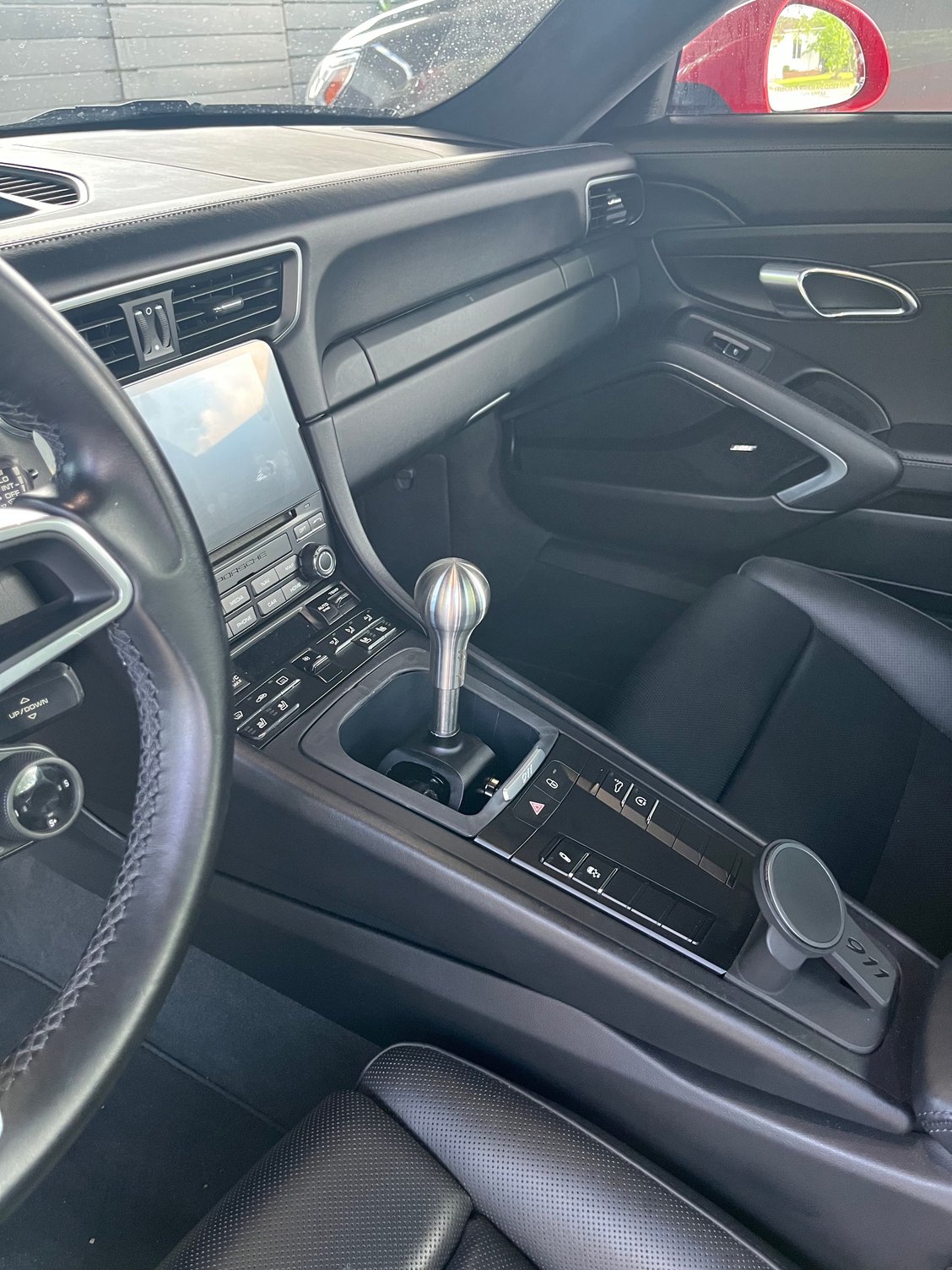

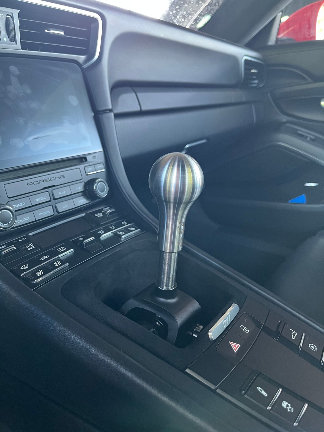

Alright guys, as promised here are the photos of the unit installed in the car. Came out exactly how I wanted.

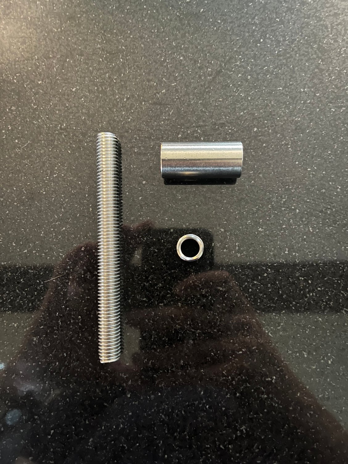

Parts needed:
(1) M12x1.75 to M10x1.5 threaded steel insert
(1) M10x1.5 x 100mm threaded rod
(1) M10x1.5 x 30mm
(1) M10x1.5 Shift **** of your choice
Optional M10x1.5 shift boot retainer to zip tie your shift boot
Installed ( don't mind the filth!)

ahhh so that smooth pipe looking part is essentially a coupler between the Numeric threaded portion and that threaded rod?

i assume something like this would work.
https://www.ebay.com/itm/22568225668...8TZ7TBN5TN686A
Correct, it’s just a threaded sleeve so that the threads aren’t exposed but at the same time adds more rigidity to the set up.
The size in the link is incorrect though, I had luck through Amazon and was even on prime

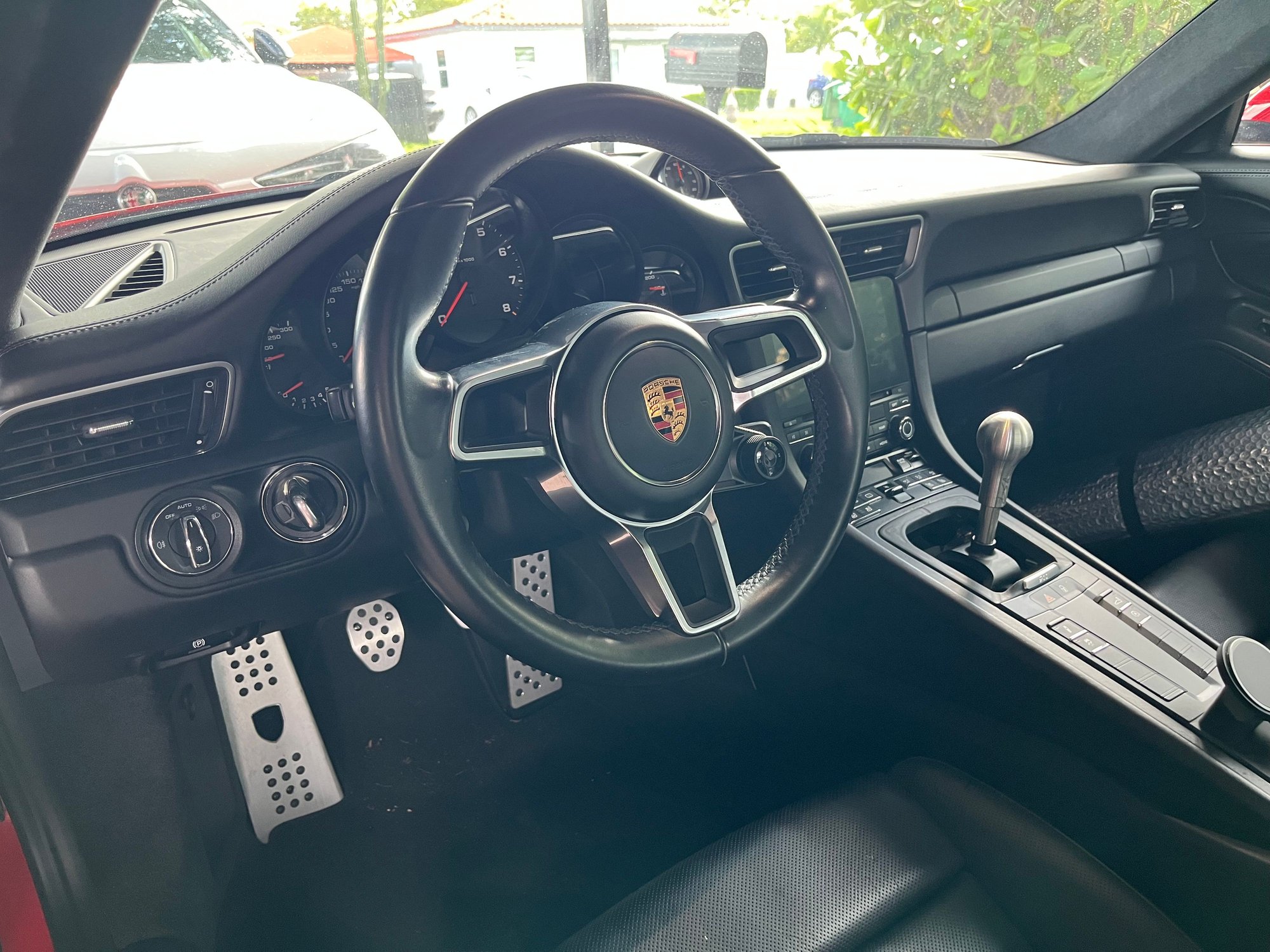

Old Apr 18, 2026 | 10:46 AM
997lurker's Avatar
997lurker
Joined: Jan 2022
Posts: 153
Likes: 118
Getting this close to final form. Added a sheet on the inside of the shifter to leave the numeric exposed. Plan to wrap the whole shifter trim and sheet in Alcantara for a finished look

Couldn’t edit the above post with the revised photo but here is the shift boot delete wrapped in alcantara
I always felt the numeric shifter was too pretty hide. - Nice work
Right? Such a nice expensive piece to be hidden. This project turned out a lot better than I expected. I'm happy with the result and its always 100% reversible!
Shifter looks great! Quick question on a side note… I like that phone holder/charger. Is it magnetic and any issues with draining down the battery as it’s always plugged into the lighter plug?
