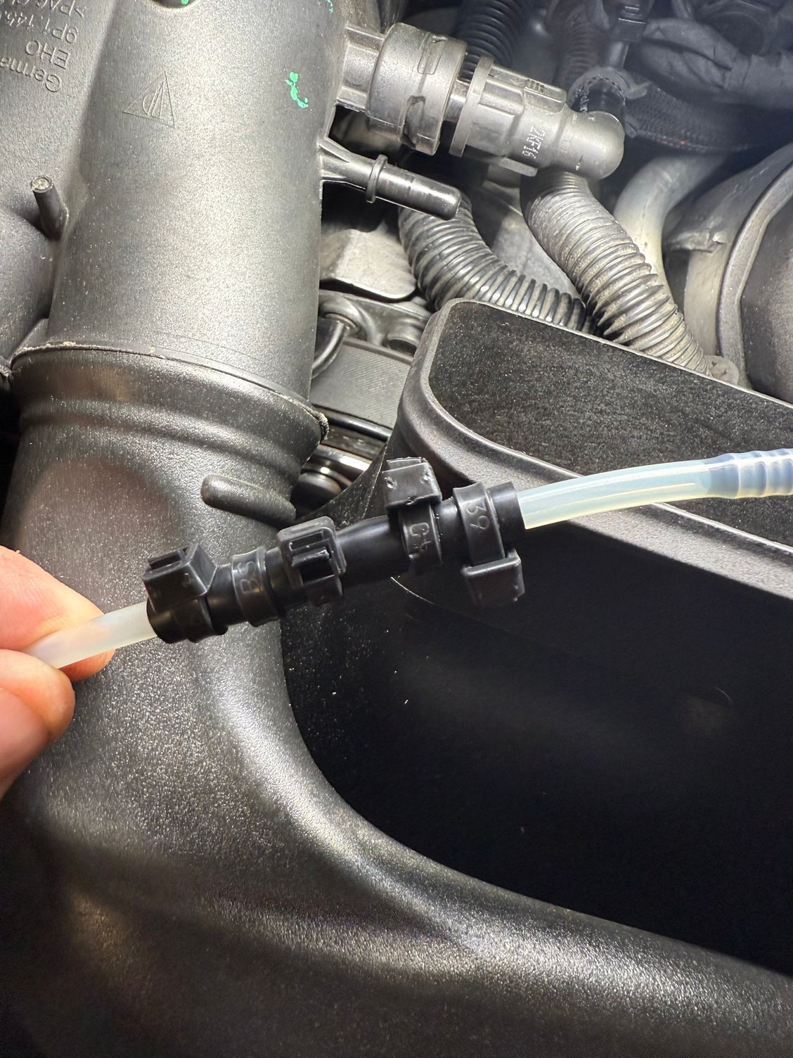

I can tell you from personal experience that when I had almost the exact same amount of boost leak (maxing out at about 10-11 PSI) this was the culprit. Replaced it brought the boost back. These lines are hard and can break easy. It’s one of the vacuum lines that plugs into the y-pipe.

Not directly. That line connects to the cluster that sits in the middle between the y-pipe and the engine air filter cover.

First I Mcgyver'd it by connecting the two broken ends inside of a rubber sleeve and cinched it down with some zip ties. Honestly, it was probably a perfect repair but I still ordered the replacement part for about $40 from my local Porsche dealership parts department. I then replaced the fixed one with the new one.
It was quite a learning experience for me though. In the process of seeking a solution to repair, I discovered that finding OEM parts (not Porsche brand) that are exact in specification was very hard. I went to two auto parts stores, an Ace Hardware and a Home Depot. Nobody sells vacuum lines/hoses that are the same. It's like Porsche created their own hose material. But I did manage to buy a few lengths of different tube/hose material to play around with and experiment in the event of another breakage. I also bought a couple of other tools, one of which (Single Ear Hose Clamp & Pincer kit) I used to resecure the hose coupling that connects the diverter valve to the cluster of other vacuum lines. I managed to find some 'close enough' alternatives to Porsche brand. It's shocking (not really) how much these parts cost if you buy them from Porsche. For instance, Porsche sells the hard vacuum line from the diverter valve for almost $100 per side. That whole cluster of vacuum lines & hoses that's nestled together between the Y pipe and the air filter will run you several hundred dollars. Maybe 1000. Ridiculous. You can find stuff that's almost the same for a few bucks but it takes a bit of trial and error.

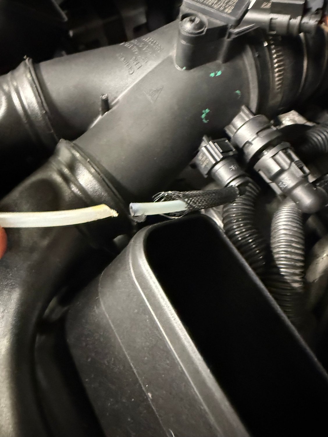

If the diverter valves aren't getting boost pressure behind them on acceleration due to a cracked or leaking line, they will push open under boost and air will begin recirculating from the post-turbo to the pre-turbo side. The diverter valve springs are pretty weak and rely on boost pressure behind them to 'balance' the pressure above and below the diaphragm so the little strength of the spring can keep the valve closed. I'm guessing the rushing air you're hearing is the air recirculating into the turbo inlet under throttle. With the leaking the line, the boost below the diaphragm (charge pipe) will be higher than whatever it's seeing above it from the line going to the nipple, and it will start to open under mild boost.This is bringing me back to my VW days (who am I kidding, I still have my MK4) when this would happen . Under normal conditions only the sudden increase in vacuum when the throttle snaps closed, or you clutch in and let it idle, defeats the spring and opens the valves to bleed off the boost and recirculate it into the turbo inlet, but in your case, it's likely opening under throttle.
This also lines up with it not pulling like it should. If the diverter valves are bleeding boost under throttle, it’s never going to hit target. The ECU’s smart enough to compensate and make the car seem like it’s running fine with no misfires, no limp mode; but it’s down on power the whole time.

Found the leak and it was the intake hose that gives vacuum to the diverter valves. It was not completely seperated but cracked so I missed it the first time. Can now get 18psi and no weird noises. Thanks to all who gave advice and support.
