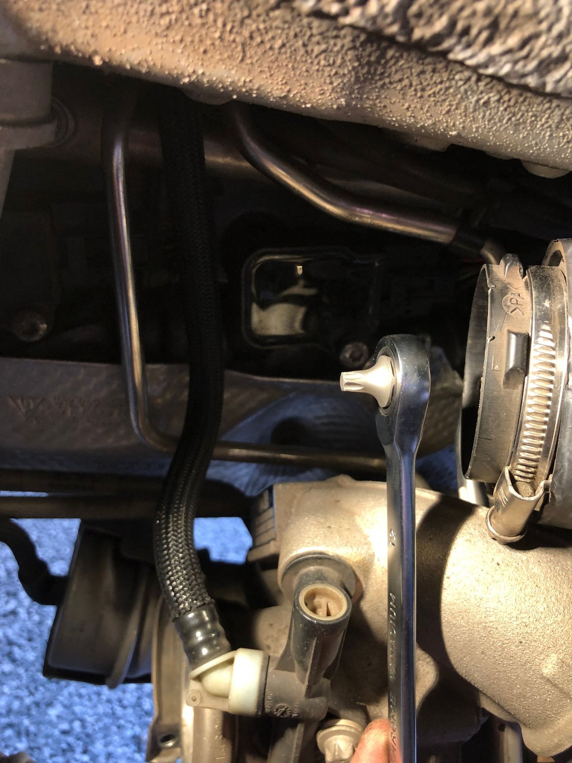

I’m of the other opinion that taking off the fascia and IC cages is a waste of time that provides minimal additional access. Sure, you can see stuff a little easier, but you’re still squeezing your hands in there and using extensions with wobble sockets to do the job. You can do it perfectly fine without wasting many more hours removing and reinstalling all that stuff. Once the car is in the air and wheels are off, spark plugs should take no more than an hour per side, so why more than double the amount of work you have to do?
edit: I do recommend a set of low-profile torx bits that come with the wrench like this:
these tend to come in handy very frequently working around the 991 engine.
