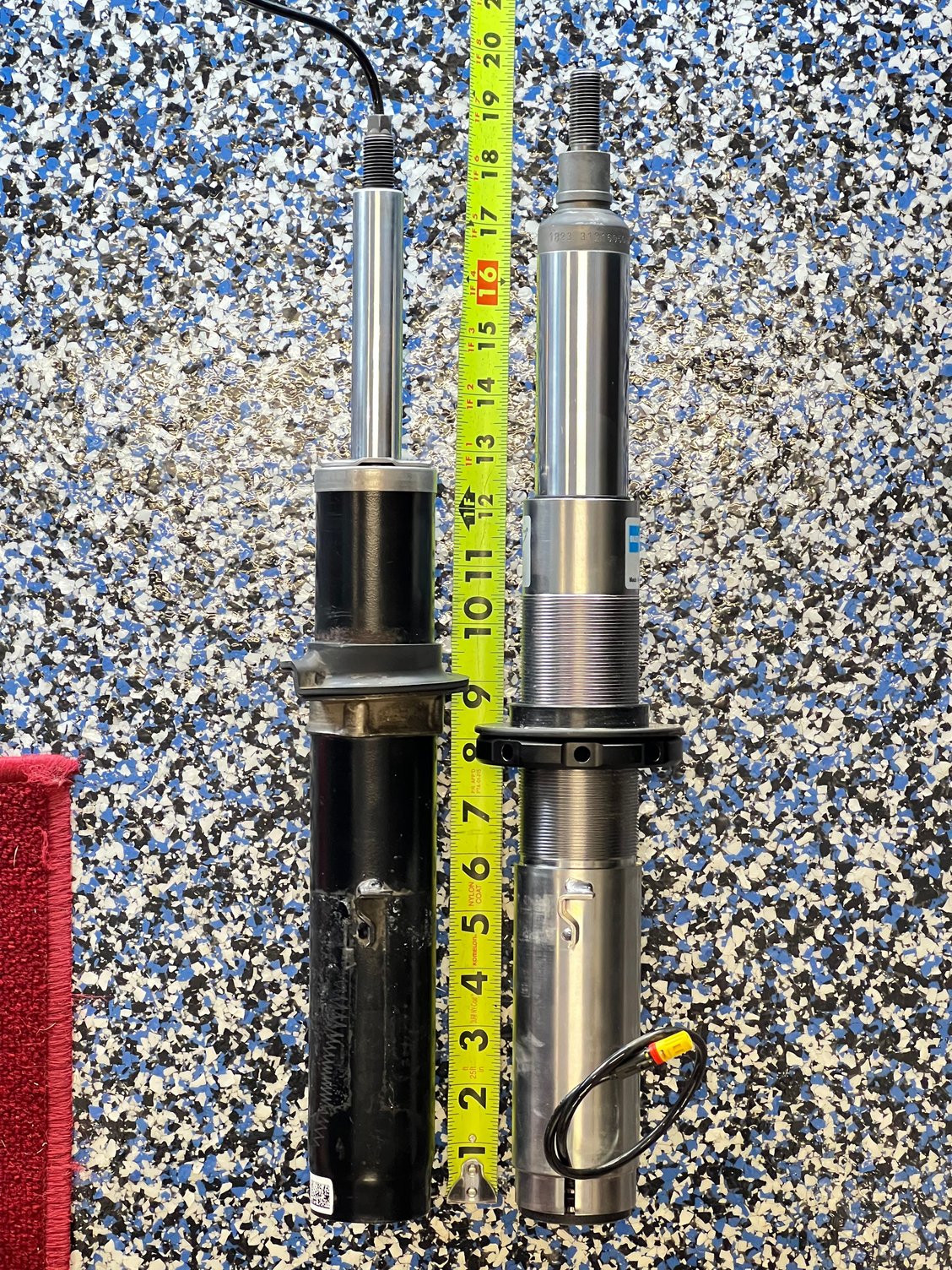

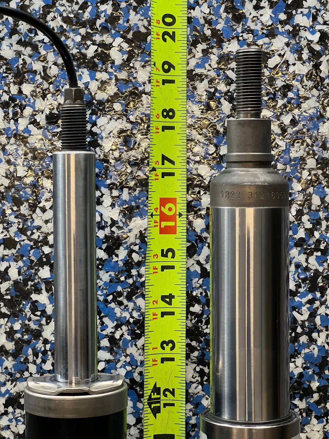

Sent these images over to Bilstein. I can’t figure how it’s even possible to get a 40mm drop over stock when the strut shaft is already taller than the OEM, yet the lower body is the same size. At 40mm drop the shaft would blow out the bottom, no?
