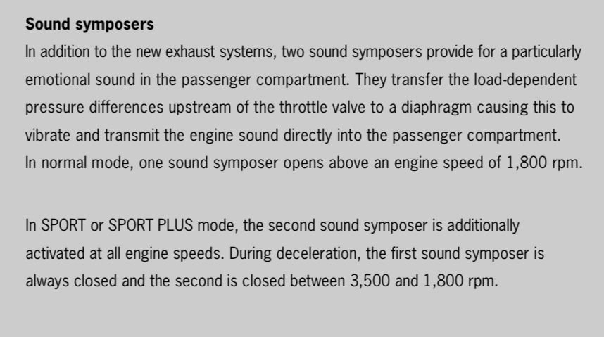

Apologies, I’m confusing 991 and 981. For 991.1 Porsche says:
"Sound symposers
In addition to the new exhaust systems, two sound symposers provide for a particularly emotional sound in the passenger compartment. They transfer the load-dependent pressure differences upstream of the throttle valve to a diaphragm causing this to vibrate and transmit the engine sound directly into the passenger compartment. In normal mode, one sound symposer opens above an engine speed of 1,800 rpm.
In SPORT or SPORT PLUS mode, the second sound symposer is additionally activated at all engine speeds. During deceleration, the first sound symposer is always closed and the second is closed between 3,500 and 1,800 rpm.

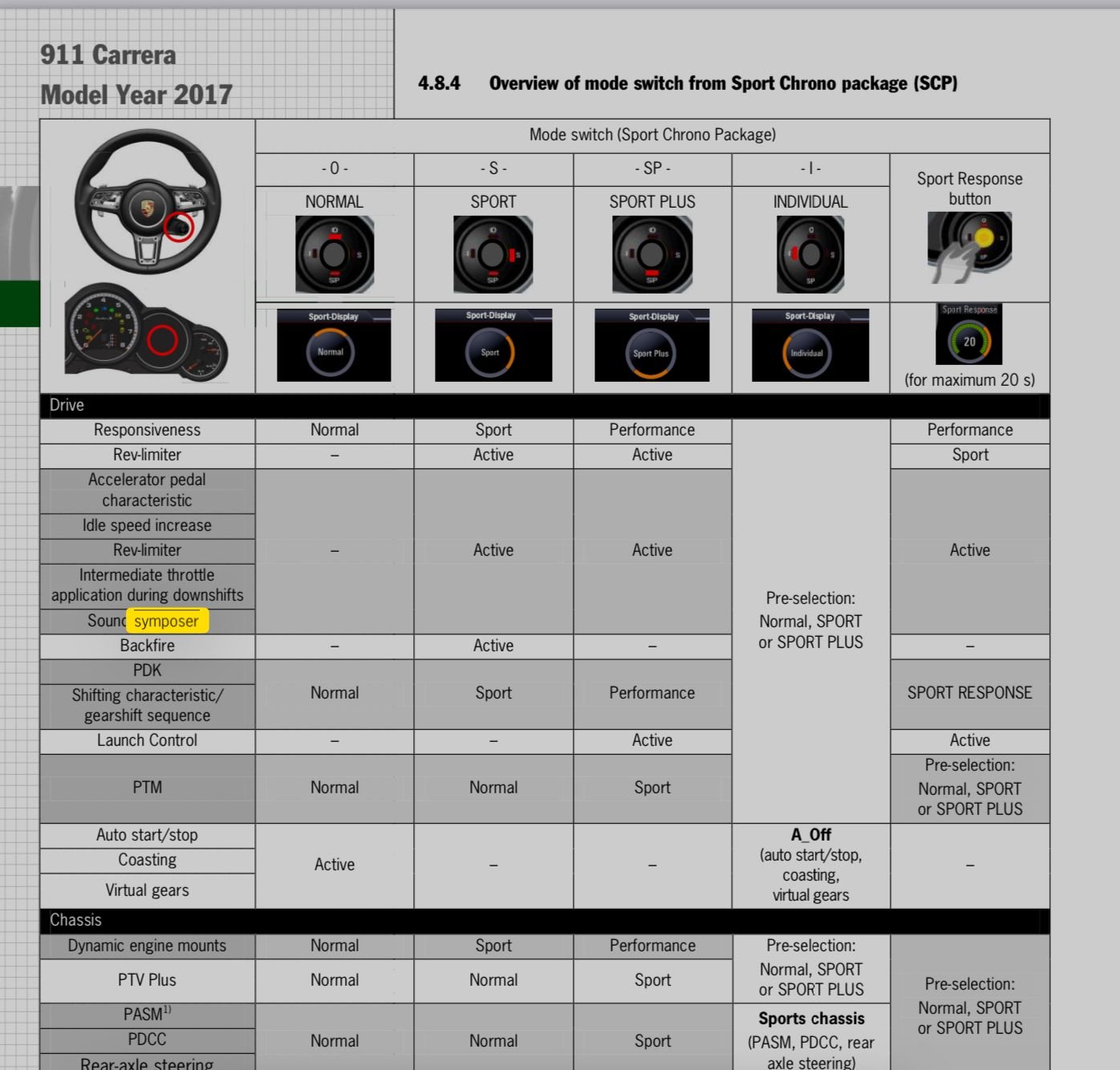

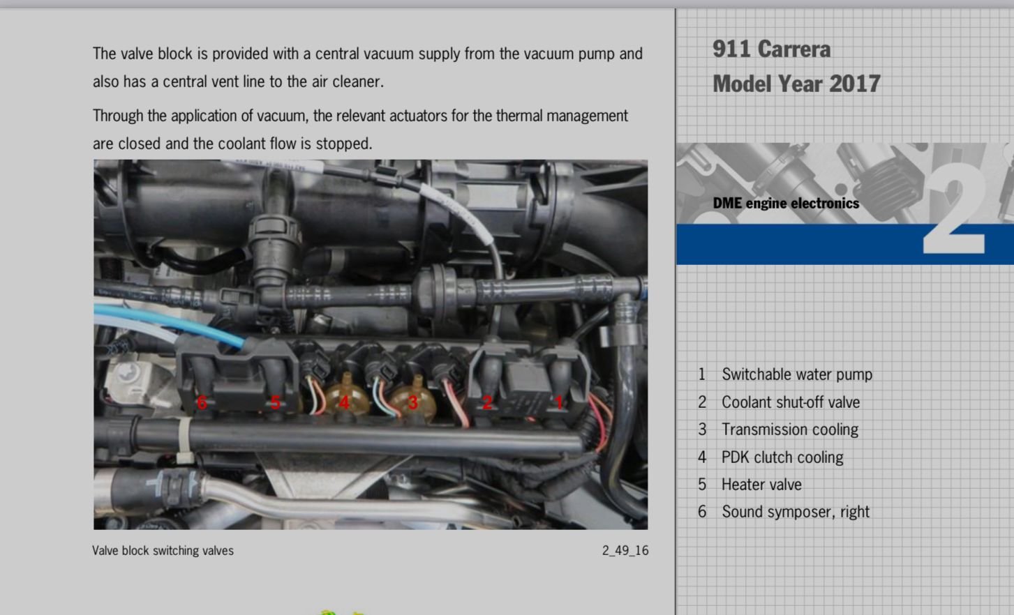

Didn’t see your MY or features but this gives you and idea.
