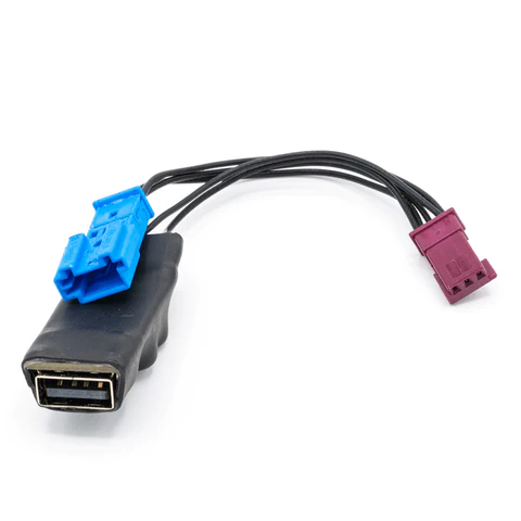

Feb 16, 2023 | 06:05 PM
Have not tried, but assuming this will work from the mirror to power the USB port and no need to run a wire to the fuse box
https://dongar.tech/products/porsche-keyway1

Feb 18, 2023 | 03:18 AM
Quote: Have not tried, but assuming this will work from the mirror to power the USB port and no need to run a wire to the fuse box
Looks promising

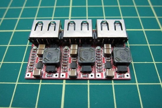

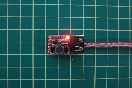

Feb 18, 2023 | 05:54 PM
Quote: Got the Garmin Mini 2 hooked up to the OBD port.
Same here but hooked up to a USB port connected to the wiring at the mirror without any damage to existing wiring.
Those USB ports are a dollar off ebay. Finished product, a few cents more.
By the way, I used the info on this site to remove the panel, etc.
