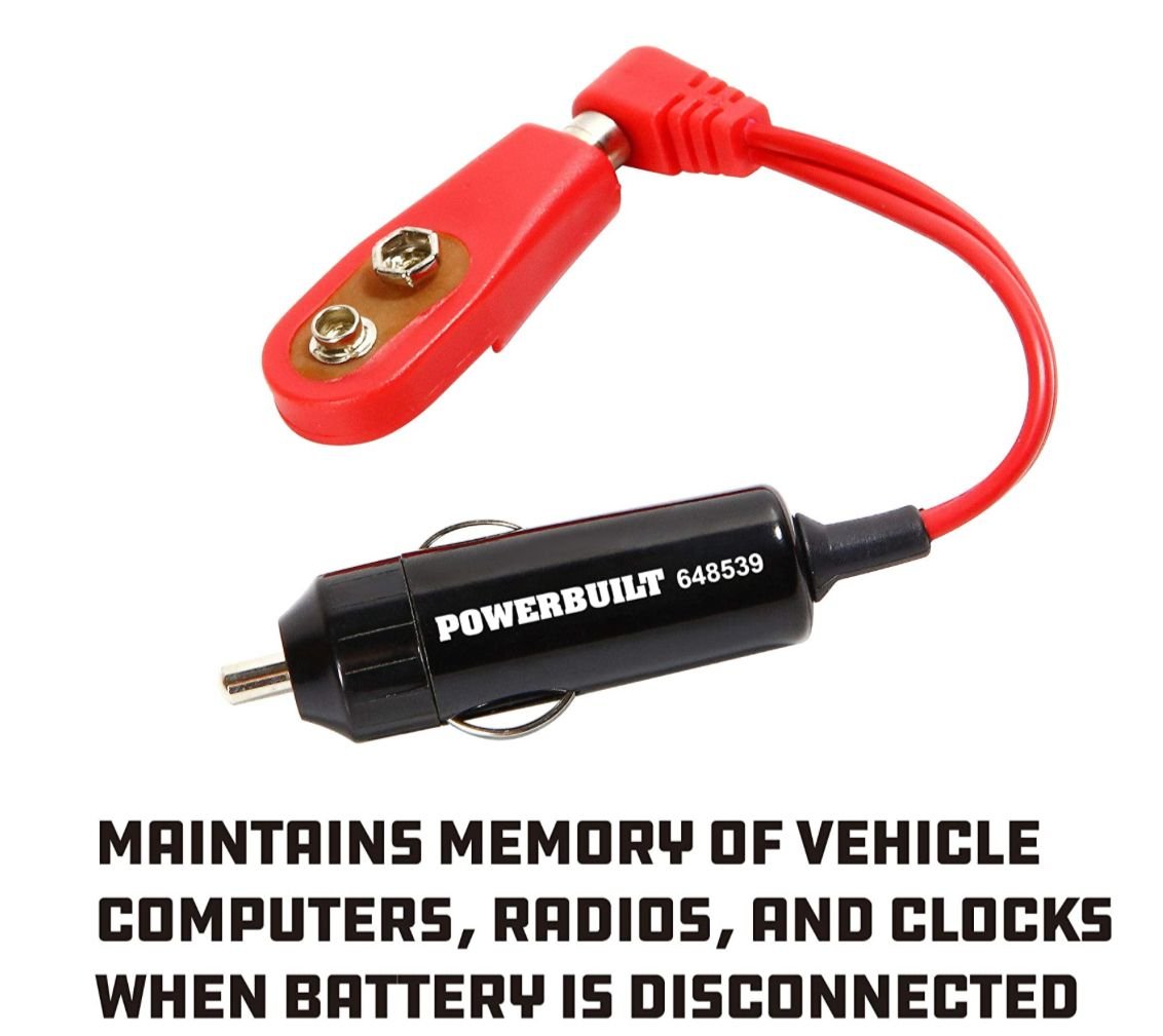

Hogwash the battery is not the issue ... Most likely you disconnected the old battery without providing continual power to the car during the replacement and thus all the waning lights. Take it for a drive and and the warnings should go away if they don't take it to an independent Porsche shop so they can reset the system.

How long are you all leaving the battery unplugged? I just unplugged the original, swapped it out real quick, plugged in the new and called it a day. No issues, didn’t bother hooking up the charger, just yolo’d it. I used an Interstate AGM, so far so good.

Would using the 9 volt battery thing in the cigarette lighter help with this when charging out a battery?
