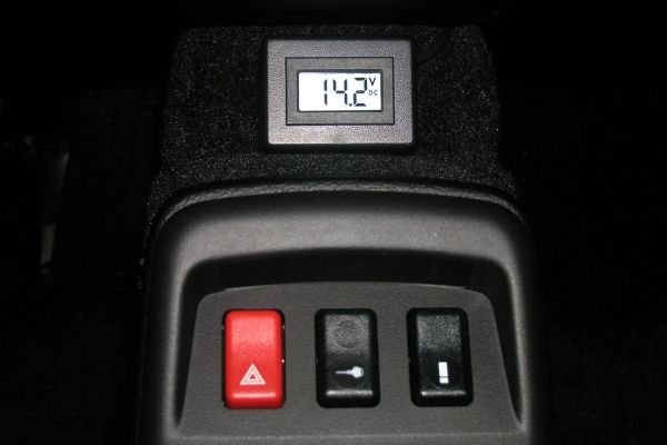

Both batteries were factory fitted in Japan and made by Panasonic (I use their NiMH and Eneloop AA and AAA batteries for well over a decade). Unfortunately, their car batteries are not available aftermarket. I now use East Penn batteries. Both factory batteries were FLA (Flooded Lead Acid) which means it has caps and they can be maintained. I might add a 1/4" of distilled water to each cell every two years. It is one of the reasons why I have no use for AGM or GEL cells. although the 991 and the BMW motorcycle I now have, have AGM batteries. And another thing, there is no such thing as a "sealed battery" as claimed by AGM and GEL advertising because if they were, we'd all be in trouble. They are VRLA (Valve Regulated Lead Acid) batteries. They have caps and each cap or the battery is Valve Regulated.
I make sure my battery terminals are clean and so are the ones at the alternator and starter...all high current carrying wires.
And then I keep an eye on the charging system periodically. All my vehicles have a voltmeter install. Comes from my flying days. I like to know what is going on.
The 991 comes with one in the MID.
Porsche 993 while idling...
BMW R1150 GS Adventure voltage in "float mode"...
