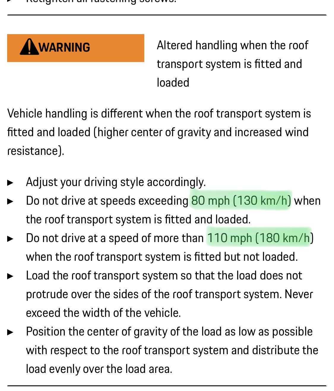

Found it.

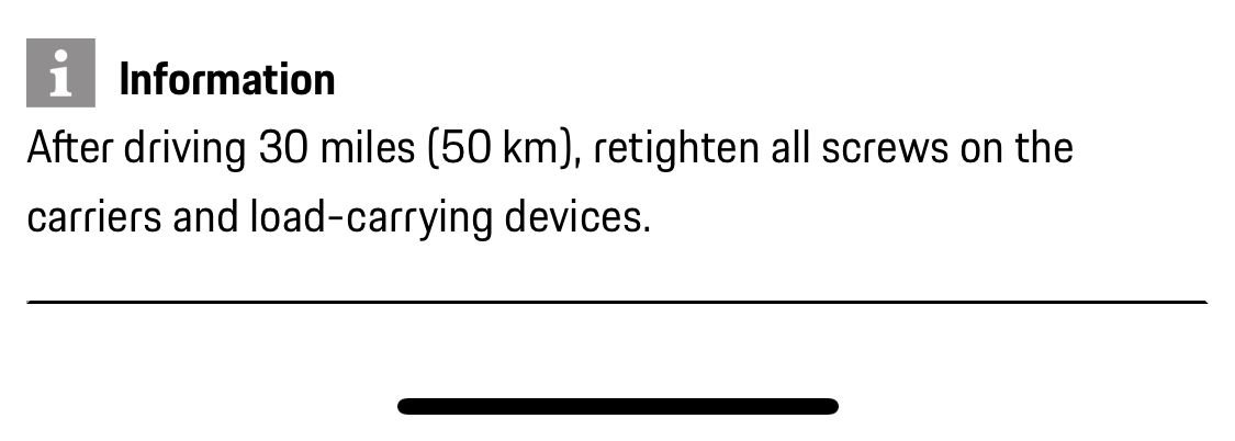

This too. Good idea. Will take a spirited drive around town today and retighten everything.
